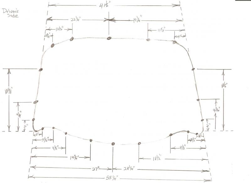

I'm getting ready to install deck filler panel on my 1969 superbee.When i ordered the new one i thought it would have holes in it for trim clips.does anyone have measurements or pic. so i can put holes in correct spot. Thank You in advance for help.

Here's measurements taken off of a 2 door 69 Coronet. 3/8" depth for the holes from the body side edge.

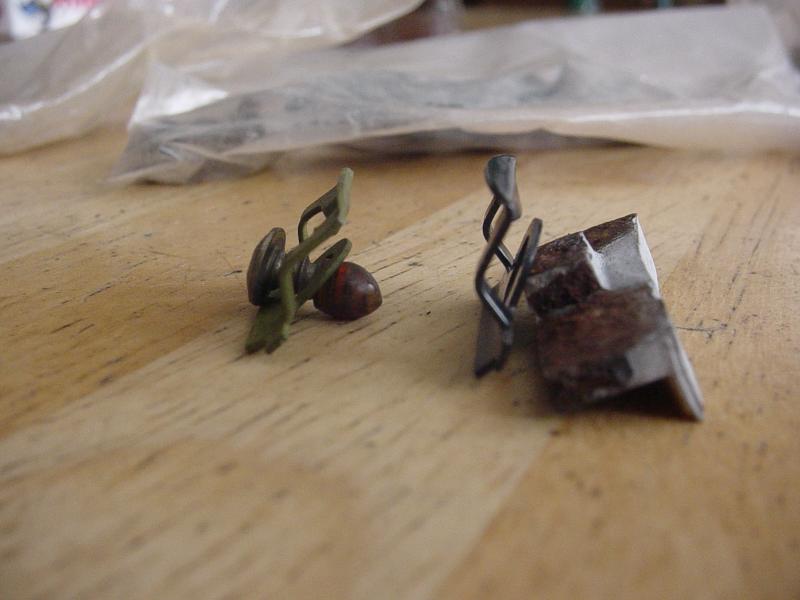

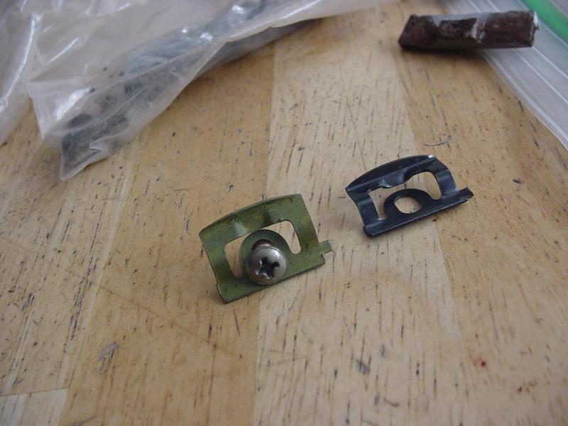

Nice job there "coledavis01". :hello2: Very well done & exactly right!! 9 across the bottom & the clips should look like this. NOS on the left & repro`s on the right.
