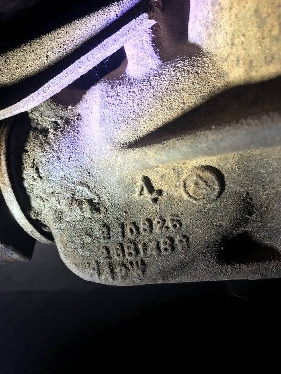

Hey guys new here first post actually. I have a number matching 1970 roadrunner but don't know what all the numbers on the rearend means or how to tell if it's a sure grip I know it's a 8 3/4 but that's it. Please help.
The 489 means you've got a good one (large pinion), to see if it's a sure grip jack the tires up and spin one wheel.. if both turn the same direction it's a sure grip:thumbsup:.

Got ya just wasn't sure if the were any numbers to indicate it.

The 489 means you've got a good one (large pinion),..............
Yes, more than likely, but.......... there can be exceptions.

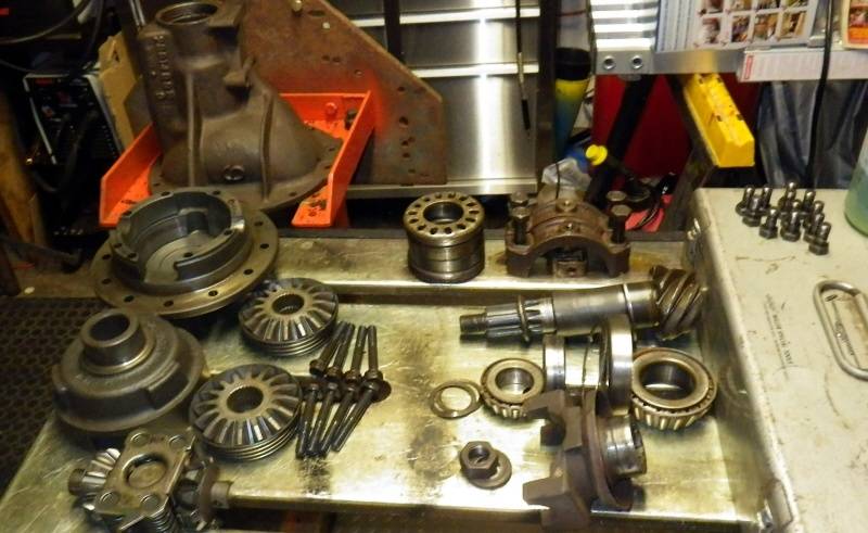

Look what came out of my 489 case.................
