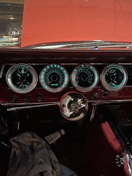

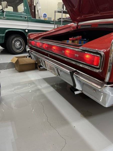

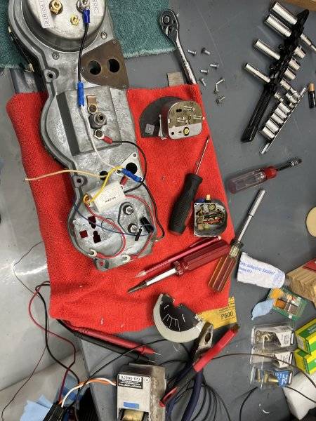

Finished the dash rebuild plus new wiring harnesses (dash and engine bay) new charging system and battery and LED light conversion. Including Headlamps. LED headlights worth every penny. Hidden headlamps repaired.
The GuageDoc was extremely helpful with EL power issues and update of tach.
All working and for the first in ownership I can feel confident about driving the car.
