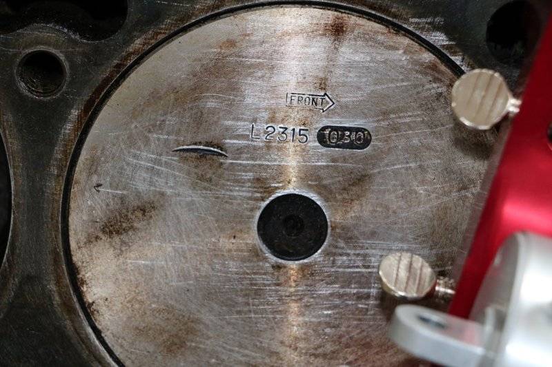

I just scraped the carbon off the pistons on my old 383. It has the Speed Pro 2315 pistons. I don't think the block was decked, but the pistons are 0.025" below the deck? I guess this would make my block height closer to 9.993". At least it was the same on the #1 and #6 pistons that I checked. On the #6 piston there is a mark where the Intake valve hit the piston when I over-reved the engine. Not really a P-V clearance issue, but 727 shift kit that lets you select 1st gear at any speed.
