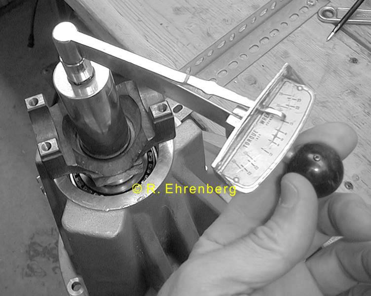

You add/subtract the preload shims (small ones) until the correct turning torque is obtained. Did you use a in/lb torque wrench? I've done enough to get close by feel myself , but I still check them. It may not have enough pinion preload. How did you load the side bearings? Or you are correct. It could be used gears.

Which part did I use the correct torque wrench for? Tightening the pinion nut? I just tightened that as hard as I could, based on it being a solid preload spacer... should it have been torqued to a certain spec even with a solid spacer? I had messed around with a few combinations on the preload shims, seamed like the best was three shims as mentioned.

set pinion depth. Shim preload bearings. Check by rotating the pinion with the in/lb torque wrench. 15-20in/lb. Set the backlash then zero, then tighten the right side adjuster to obtain .006-.009" backlash
