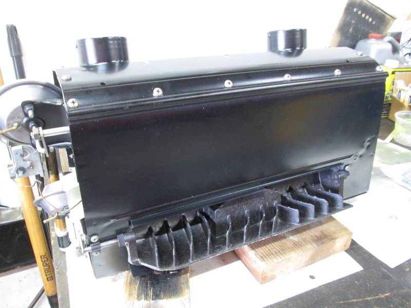

Rebuilt my heater box
Are you guys oiling all the bare metal parts after the RPM?
I wiped down the back panel, as per the picture above with gun oil. Worked and looked nice. Mopar left it bare to rust, figured it was one step up. If you see my resto thread, my steering column shaft and coupler are rusting already in a controlled 35% humidity shop. Coated 9 months ago with RPM.

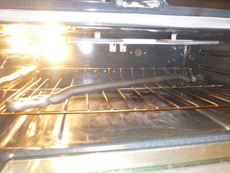

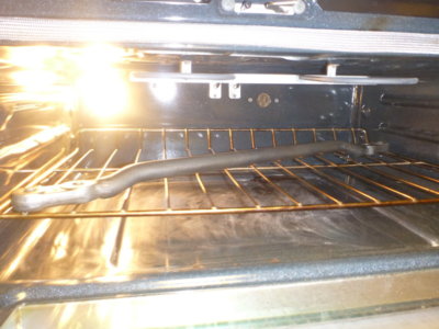

My suspention parts are all painted to mimic a somewhat original look. Not OE by a mile, but holding up well after a couple years.
I've gone through 2.5 tins of RPM and countless hours of warming up parts and coating! Should have listened to that Justin guy about 1.5 years ago..... :mad:
I went with resto rick’s “quasimoline” on my lower control arms.
I drive my junk a few hundred miles a year. It has seen rain a few times and lots of dust and road debris.
On a humorous note, the wife was none too happy about a cookie sheet of mopar parts in her oven today. :blah:
They always know when to come home... LMAO

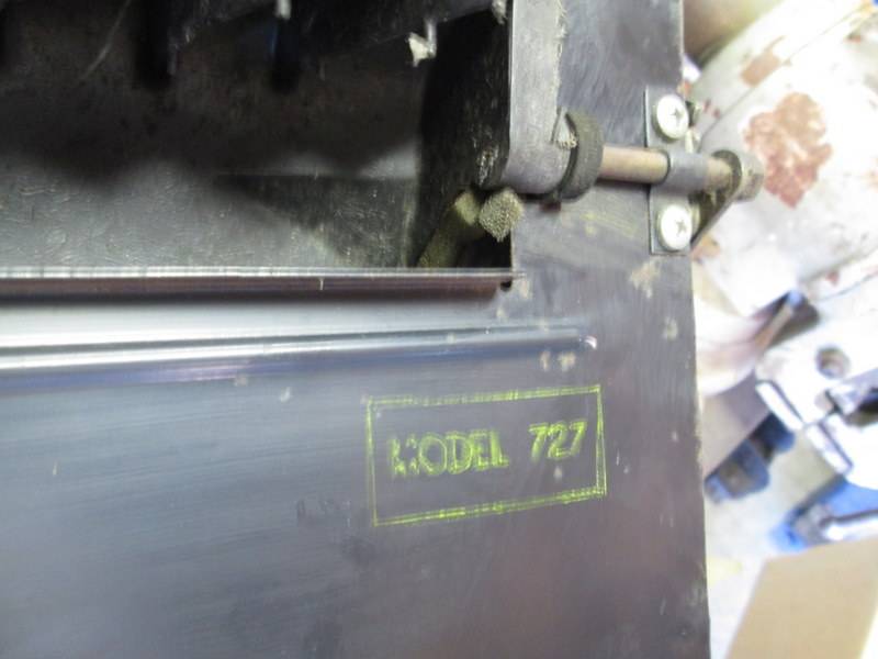

I did my H/B earlier this year also. Does anyone have, or know where to get a stamp like they used to ID the models ?
So on the heater box bare metal pieces you are saying you used boeshield or gun oil only and that is the final finish? Or would you spray them with a clear?
Only minor surface rust after 50 years from Chrysler leaving it bare metal, I figured a wipe down with gun oil was good enough for my life time and the next two owners. Nobody is going to see it again until they scrap the car in 2100 ! :eek::eek:
Okay. I'm planning to soak everything in the evapo-rust today. Then I will look to get it coated right away. I was assuming to use a clear spray but maybe I will try the gun oil.
Thanks for the reply
