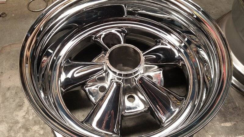

Well gentlemen, I'm excited to report that after five and a half months I got my wheels back and they are better then new. The wheels were disassembled so the aluminum centers could go in one process and the steel wheels would go to another. The quality of the chrome AND the welds is superior!! I could not he happier and they kept to their original estimate of $565 each. I've included a picture of the back side as they polished the rim and chromed it too. The back side did not look like this on the original wheel. The folks that recognize the original old school Cragar S/S will recognize these and be amazed. Thank you all for your support though this project. Just ordered a new set of P245/60R 14 BF Goodrich Radial T/A's.

View attachment 1262467 View attachment 1262469 View attachment 1262470 View attachment 1262471
Look gorgeous
