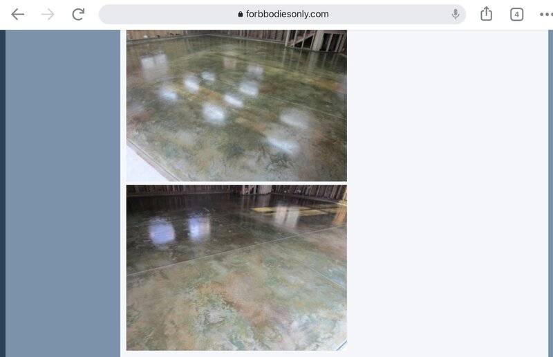

This company gets excellent reviews on garagejournal.com. I used their stain and sealer on my floor and it came out really nice. I think there’s some pics of my floor on my garage build thread on here and garagejournal.com. There’s a ton of installs of their product on that forum too.

Here’s my floor

Man we must think alike, my floor is very similar with the variety of color, looks great! Have you spilled any gasoline, thinners or harsh cleaners on it yet?
Yes, I’ve spilled gas, paint thinner and over-sprayed brake cleaner, PB Blast and WD40 on it with no effect.
