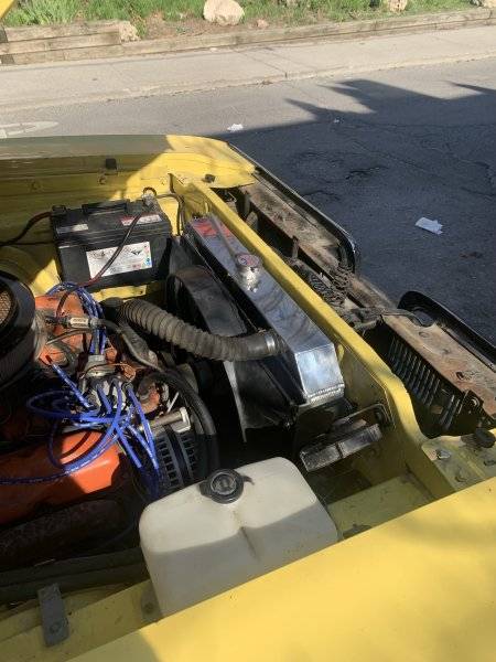

Here's one of Glenray's on my '63, and I'm quite happy with it.
View attachment 1453309View attachment 1453310
I think a Few of us here will be waiting to see who that will be ? Post them up when you have a chance, Thanks...
Glen Ray does good work and that radiator looks great but they are local shops all over the USA as others have mentioned that, don’t need to advertise, save you alot of money because they are local, been in the business as long or longer and do just as good or better work then Glen Ray. You may not be as fortunate as I am but I have at least 5 people within 30 minutes of me that can recore and 2 of them is on par with GR, 1 maybe better, he owns a few Mopars and recores radiators for my dads heavy equipment. If I ever get back over to his shop I’ll take a pic of his GTX and RR radiator.

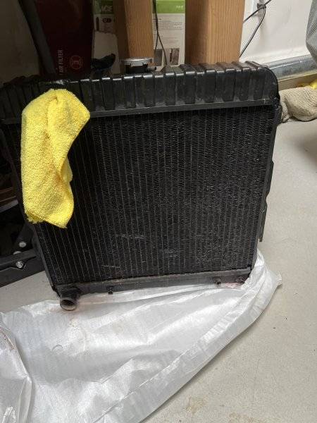

I stopped down to the radiator shop today and got the news i sort of was anticipating,they tanked it and pressure tested (good). They seem to think it's ab out 20% plugged and could be rodded but no guaranties. It's back in the garage for maybe another time. Found an aluminum 2-row 1-1/4" tubes through a shop in minnesota..Ebay...It's a gamble but we'll see.Going to dry fit it when it arrives and see if i have to modify,but it's supposed to fit right down to my factory shroud.

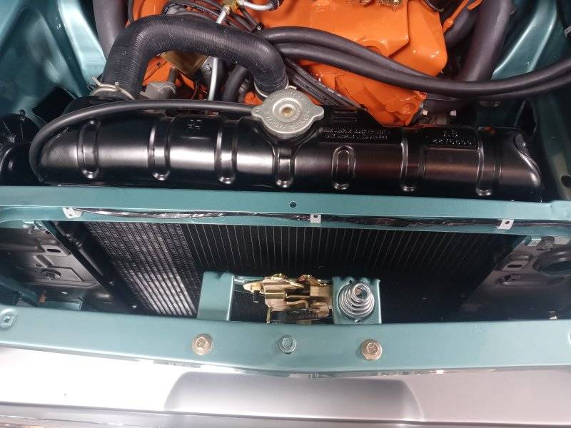

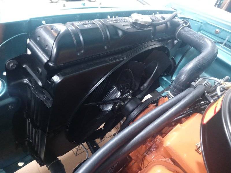

I see this being chatted up here and just wanted to throw out a couple of questions to everyone. I have a stock 383 in my 70rr that has been running quite hot. By the dash gauge it moves up quick to 200-230*,but I hear that those factory gauges can be off by 30 degrees or so. I have a 160* thermostat and when I run here in Arizona she gets very hot. The other day got back from a ride out to my buddies shop and it was about 80* outside and was 45mph moving traffic and the dash gauge went to to max.260*. When I got back the over flow tank (plastic) was boiling like a pan on the stove. Kinda scary!!
Went to pull the factory 22” out and noticed draining out the coolant that it seemed I never really got the 14.5 quarts + the engine blocks worth of coolant.
My buddy suggested that this old copper/brass factory radiator is done or plugged and to make the leap to a 2row aluminum unit and cooling problem solved. I’d like to keep a factory radiator in it cause that’s what came in it. Worked for 53 years why not another 53? The question to anyone is: Is it worth it to recore this original and maybe get it dipped and rodded or get a replacement factory or go aftermarket aluminum?

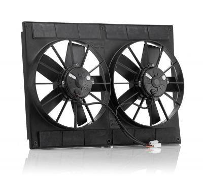

I do like this double fan option. Does this fit on 22" and 26" rads?
