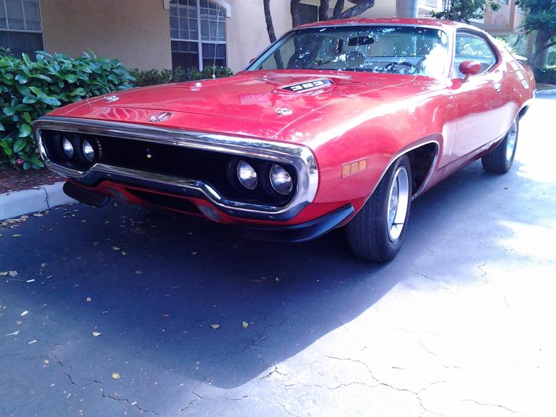

Hey guys. I've been a long time lurker and now I'm finally redoing my mopar. Any suggestions for must haves for a mainly street occasional strip car? My car is a Tor Red AC car with white interior and power windows, but no power steering or brakes. Will probably upgrade steering and brakes and wiring. Also, I have a certificate for 65% off from my first order from painless, so will probably be getting my wiring from there. Anything else I should get from them and do any of you guys need to get anything from them?
As you can see, it is a much cleaner start than most have to work with, but it is just not what i want from it. I have already reine the 440 and made a 505 stroker and rebuilt 727. Brakes are manual drums, yuck. Lol Thanks, Chris

That's a sweet 71 Lazarus! You should head over to the welcome wagon forum and photo bomb an introduction. Interior too. Your color combo is really nice.

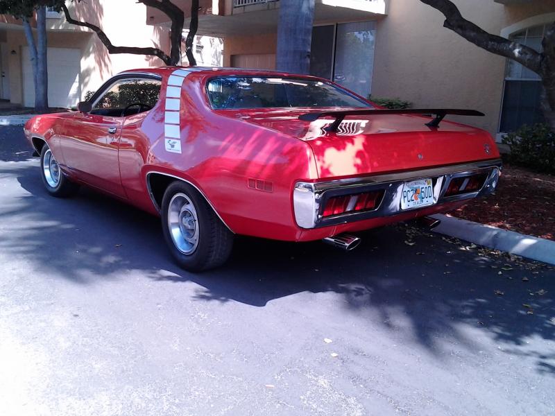

No tubs. USCartool subframes. 11" hemi drums work good for me. Add AC, Vintage or Classic Auto Air, power windows from a1 electric include regulators. Sweet ride.

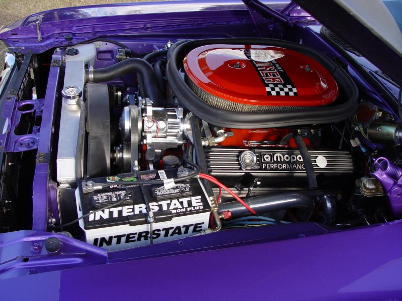

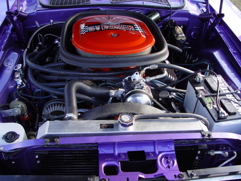

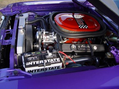

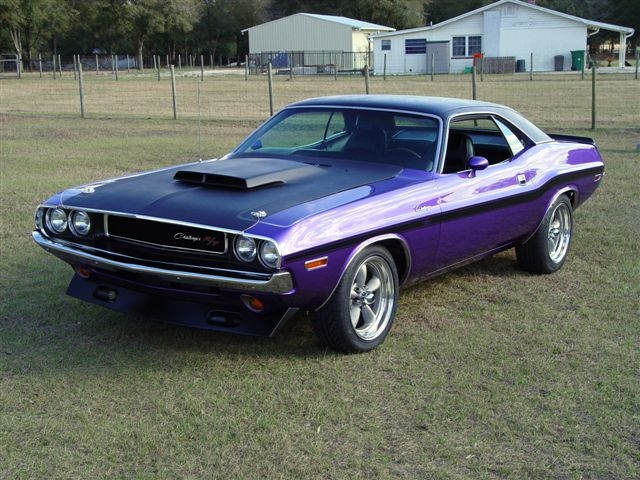

Several years ago I restored of 1970 Challenger R/T that has a Herb McCandless built stroker 440 engine that now sports 500 cubic inches and has Indy heads.
The car also has a 6 speed manual trans and has been dyno tested and makes a little over 600 HP with a mild cam.
Using this system on the Challenger was a breeze to install and did not require any cutting, just had to drill a few extra holes in the frame rails.
This car makes monster torque an wheel spin is not a problem. If you don't care about originality and you want something that works I would think seriously about this set up.
Another advantage is that the tail pipes can exit in the factory locations, where as if you move the springs inboard the tail piles will probably hit the springs.
The ground pounder set up uses a quad shock arrangement to help control axle wind up.
You can run the modern Sanden 508 A/C compressor. Think AR makes the BB brackets

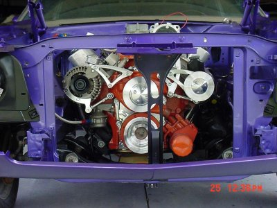

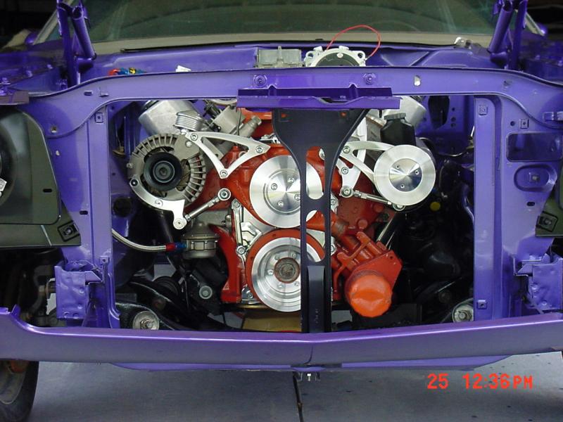

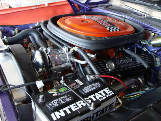

Also on the Challenger we used a serpentine conversion system with billet aluminum brackets and pulleys. We had to machine a small water pump pulley spacer to make sure the belt alignment was true. We have had no problems with this change. It allowed us to install a small Sanden R-134 compressor too.
In the 2nd "front on engine" picture, the alternator didn't have the billet aluminum pulley pressed on yet. This was still part of the mock up stage. You can see it laying on top of the original pulley which is black.

Here is one we just build and it just sold at BJ Vegas.
http://www.barrett-jackson.com/application/onlinesubmission/lotdetails.aspx?ln=684&aid=524
