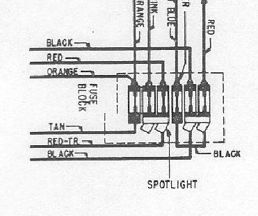

Putting original AM back in '65 Satellite.
1965 Motors Manual says plug wires into back side of fuse block in various places...no more info than that (I'm sure they presume that I'm the guy that unplugged them.)
Radio has had wires cut so no help there.
The diagrams I see on the internet don't give me much.
I've got an Orange, a Red, a Black and a Green.......all the same gauge.
Can anyone tell me which is which?
If I remember correctly! The Red is to the fused power, the orange is for the light, and Black and green are for the speaker
does it just ground through the metal box structure of the radio with no wire?
what they said. Just to add Black is negative for speaker, green is positive. When stereo, Violet is the other channel positiove and black is common negative for both speakers
Orange is for light, goes straight to the fuse box.
