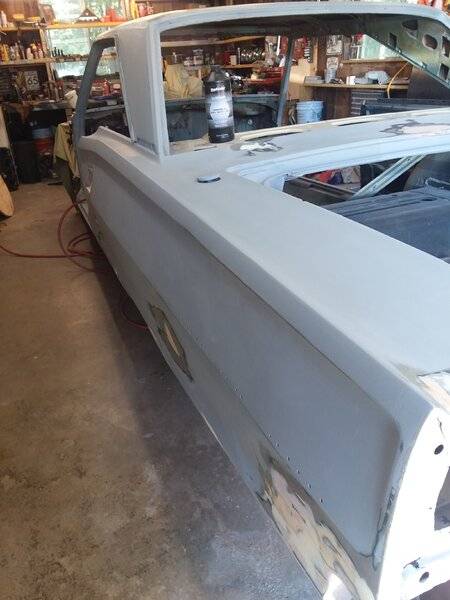

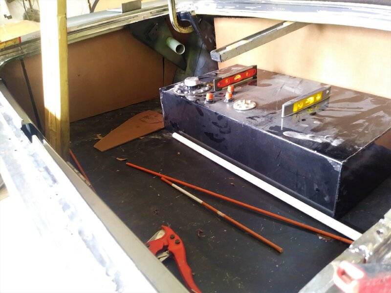

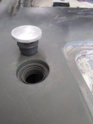

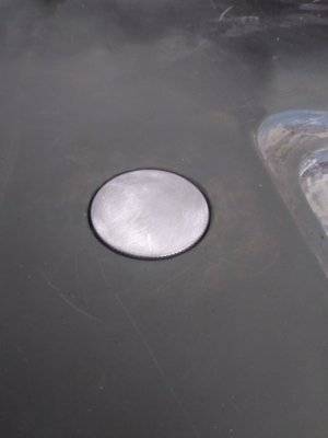

Well, yes and no. You're never stuck while you have the imagination and skills to bring your ideas to reality. I went the fuel cell route and placed two motorcycle style pop up filler cap/necks on the quarter tops next to the front corners of the trunk lid on my 67 Coronet. They are from Rullo Caps and have an aluminum body with a weld to neck to attach to the quarter skin. I routed the filler tubes down and through the body of my trunk lid gas lift braces. Easy peasy. Look tough too. Now, to answer your question, yes, it's likely that you can modify the stock tank to have the filler neck routed up through the floor in the area behind the wheel well hump inside the trunk and curve forwards and up to meet a filler neck on the trunk deck. I would investigate the use of all, or parts, of a 68/69/70 Charger tank and filler neck assembly. Good luck!
