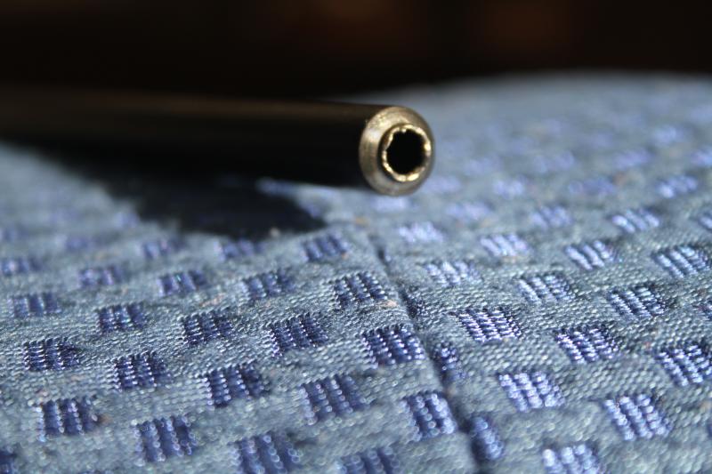

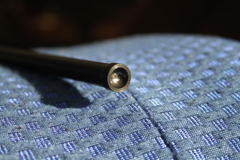

Thanks to all for the help. Went ahead and pulled the intake. Rotated the engine, inspected the lifts on #4, they all seemed to work, so I thought well maybe the lifter had a hole in it. Pulled the push rod and bingo. The tip of the rod was gone! Looked in the top of the lifter and and there was the tip of the rod, all busted into little pieces. That was on the intake, looked at the exhaust and same thing. Went to O'Reily's to get a new set of 16 and they did not have them. They have to be special ordered from Kingston and they are closed on Sat. These are Proform rockers and rods. $142.00 if they can get them. I don't like what I saw and can't explain it, so I am going to look at replacing the whole set with some other make. Any suggestions on the best ones to get, and then the most bang for the buck ones? Thanks to Lewto, Garys1969rr and Mopar 871 for your help.

Photos of Proform pushrod Part #66421C Available from Jegs and Northern and Keystone 2-3 week delivery
"Crushed" against lifter cupped end against the roller rocker
