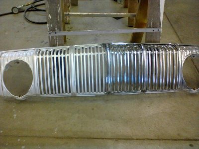

Here is the grille after the easy off, half polished

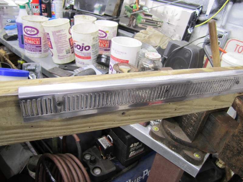

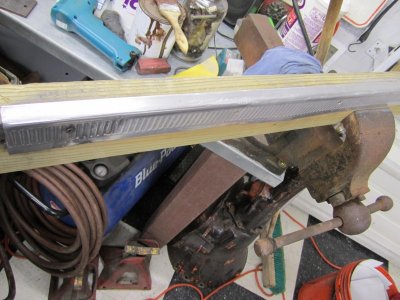

Grille lookd GREAT!,I tried to use a commercial buffing machine just holding the sill plate.The machine ripped it out of my hands causing some bends i was NOT looking for.I put gloves on and tried again with the same result.Brought them back to my shop and used the die-grinder after screwing them onto some 2x4's and they came out,,,,,,,alright,just not as nice as I was hopeing for.
eric, That looks great! Im going to use some of that Easy off and try it this way on some extra parts i have.. If it shines that good its well worth a try for sure..
Ron, after using the easy off the fun has just begun. If there are any scratches or pitting then start sanding. If it's not too bad start with 1000 grit then 1500 and finally 2000. I prefer to wet sand. Depending on what polishing compound you are using you might be able to just use the 1000 grit. try some samples and see what works for you. I really like using a die grinder for polishing. I bet I have 8 hours into the grill from start to finish and when it looks a little dull I just give it some hand polishing. Good luck!

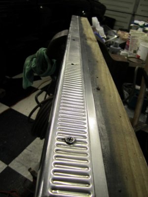

After you spend hours and hours to get yer stuff real nice,maintainance is really easy.I just did my rear rims in a half an hour,like putting wax on and buffing it off.I have alot of aluminum between my flat bed and the car:happy7:
