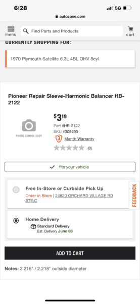

Got it alright going to order this how’s this look ?
Is that a crack on the base of the timing chain cover? Make sure there are no burrs on the outside of the vibration dampener, they can cut the seal on your timing chain cover. As said put a little oil on the inside of the vibration dampener snout and a little grease on the outside of it where is goes through the seal. The slinger goes on so it covers the seal like a cup facing out.
