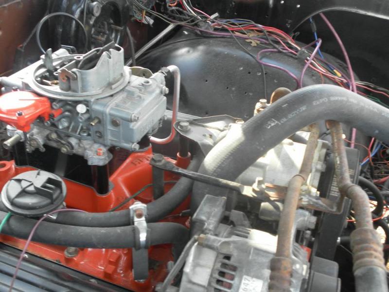

You can buy all the stuff new or used to do a non A/C V-belt stock drive setup or you can get the brackets pulleys & run this minus the A/C & upgrade to a Denso alt Cheap!!
