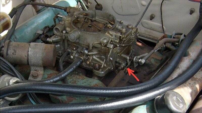

I have done this before, but not with a carb. I used alum, but I also read that nitric acid will work too. Alum will not hurt the aluminum, but you will need to take care not to get it on other steel parts. You can speed up the process by keeping it in a warm place, or point a light at it.
Having said all that, I would use this as a last resort, once I had already tried some percussive maintenance, screw extractors, etc. I would think some heat is ok, so long as you don't go full gonzo with it.
I’ve had pretty good luck using PB Blaster.
Can you show a picture of the broken screw or bolt?
That would make it easier to offer suggestions

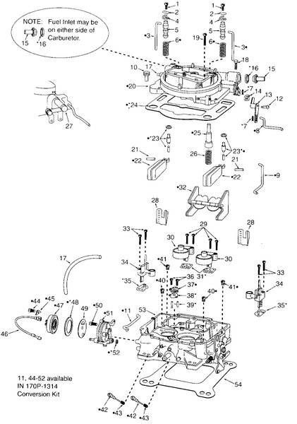

I see that I am confusing some people as to what I am
I am trying to explain....so without further ado...
Please see Item number 12 -the screw that I am talking about. It attaches number 13 to the carburetor and this is the screw that I twisted the head off from when I tried in vain to remove it.
Sorry for the confusing... my camera is broken, so no pictures till I get a new one.
I hope that this will allow everyone to see what the problem is that I am facing.
Thank everyone that has come forth in trying to help,
khyslerkid...Please my new post as I have posted a diagram of what the problem is.
Thank you
Fran Blacker... That is exactly what I am trying to say that I broke the head off of, the accelerator pump pivot screw. It seems to be bonded to the aluminum housing and that is my problem in my attempts to remove it.
