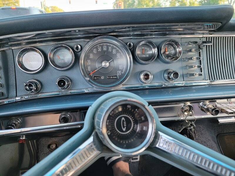

Can someone help or point me in the right direction, I want to remove my dash to test my fuel guage and the voltage limiter, my fuel and temp guages are down and I wanted to test them out see if it's a bad connection or a bad guage...

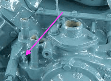

Can intake a voltage tester to that to check current? And where exactly in motor am I looking at ?
So just run a wire from that to anywhere on car and flip switch ? To test temp guage if temp moves than it is my fuel guage?
No... Ground that wire.... If the gauge moves to H the sender is the problem... Don't leave the key on for long, you can watch the gauge sweep fully to H but if you leave the key on it can damage the gauge because the sender always has some resistance & grounding the wire directly does not...
Grounding the wire to the fuel level sender in the fuel tank preforms the same test to the fuel gauge circuit...
Again don't leave the key on but the gauge should sweep.. If not the problem is in the gauge or wiring... If it does sweep the problem is the sending unit...
R/T do I get the temp sender wite.wire.. ground it to the car frame and turn key to on watching the temp guage if it moves its my fuel guage.... is there a way to test the guages not connected to the car ?
