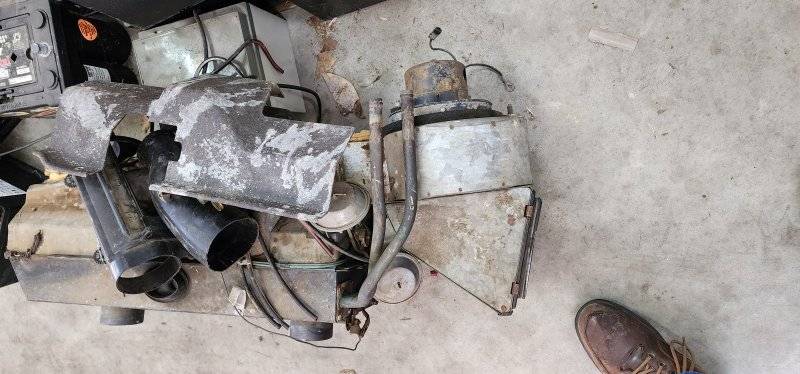

Here is one removed. No way to access the heater core without removing. This one is from a 67 Belvedere II.
AC and non AC heater cores are very different shape and size, they don't interchange.
Yes the box splits on half. I don't think it is very easy to do in the car. You could remove your box and see what's inside, it may be an easy fix. You can open the dash vent door and see inside some, but it may not be enough.
If core is bad you could put a patch on the AC firewall and put in just a heater only box from another 66-70 B body. You will need to patch over the big hole for blower motor and for the ac lines, and heater hoses are in a different place.

Yes it the same as your 67. The coronet glove box is uphigher than the charger so the access and visibility is different.
Don't take the linkage apart, unbolt the vacuum diaphragm and take it all out with the box. Don't take apart that "window" he calls it. It's just not necessary and try getting all that back together and working again.
It is doable like the video, but not as easy as it looks.

took us 4 hrs to get just the heater core section out .
the wagon seems to have extra stuff bolted to it than the ones ive seen vids on.
theres a lot more than 4 bolts and just that linkage too before it can be removed.
there are several hard to reach straps supporting it too.
