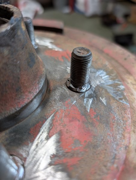

NO, that will NOT work. The studs are swagged to hold the drum to the hub. Once the swagged part is ground down then the drum can be removed from the hub. If the same hub is to be used for the new drum, you do not have to knock the studs out at all. If you try to knocked the stubs out of the hub/drum assembly without grinding, you will only destroy the drum and most likely will mess up the studs too. If you look at the studs where they go through the drum, you will see how it looks....

I am replacing the drums, so I don't care if they get ruined. So I can just grind the swages and reuse the studs. Then the drums will just slide on and off in the future like the rears?

Right. Just leave the studs in place and grind away the swagged area. Try not to grind into the stud any at all.

I learned this the hard way many moons ago when I tried to replace a couple of bad wheel studs. If they are still factory (which many are not these days but I still have a couple that are), they are not exactly easy to get apart. The factory studs for the rear are also pressed into the axle flange just like they are for the front hubs only the fronts have shoulders that are a bit longer for the swagging operation that takes place once the drums are installed.
