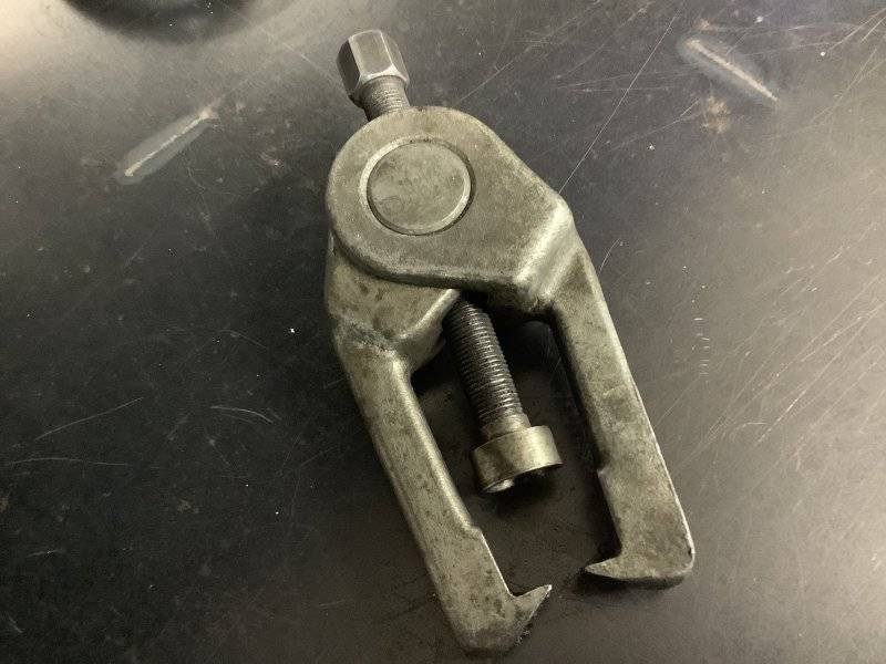

My friend Special K is going to lend me his arm puller of a different style that should work.

AutoZone used to loan the puller like the one pictured in #11, but no longer. They have the cast aluminum c shaped puller that just doesn't work well.
Where's a good place to buy the puller pictured in #11?
That’s a Matco puller
