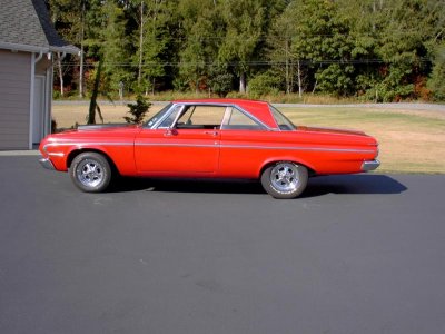

Impressive! A lot of older or even original paint jobs can be brought back to life with a little thought and a lot of elbow grease. One of the things that is a source of pride for me is the paint on my 64 Belvedere. Sure it's a little spotty and imperfect if you look close enough, but there's no way I'm repainting it anytime soon.

@Smitty: I love survivors and like to see cars, wearing the scars of the years they have been through.
Your 64 looks great!
It was a little pitty, that my 62 didn't had it's original paint, but that gave me the space to start this experiment.
Keep your 64 the way it is! never repaint!!
