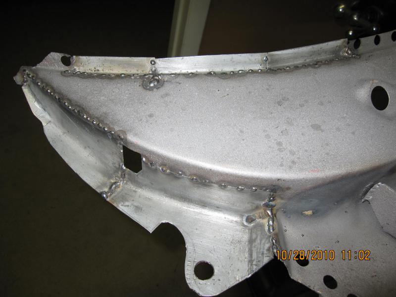

IMG_0510.jpgI had to make 5 patches to repair my right side.
Mike
