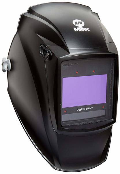

For the price Shure, and three rolls of wire also it is a great deal. Just need a helmet and some gloves and ready to play around. I have a adjustable lighting helmet, goes black when it sees a spark only way to go. From 40-250. I have used the HF ones not bad at all.
