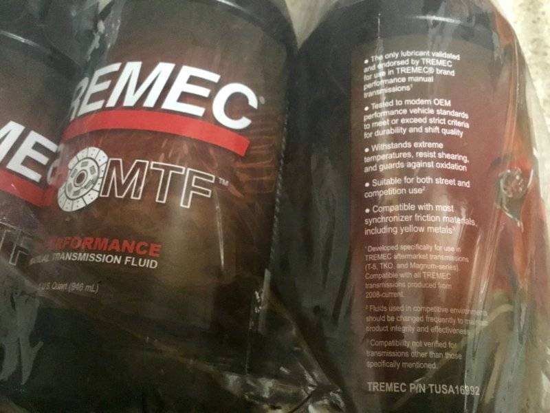

This is what Tremec sent. This to be put in after 500 mile break in. Doesn’t say viscosity or synthetic.
I ran Dextron 111 IIRC for the breakin then GM Synthetic. My buddys Gasser put the Syn in it and hammered it from day one, no problems. It should loosen up after a bit. You are spot on @ 1900 at 65MPH according to my cheat sheet with 373s and a 275-60-15 tire. Have fun.
