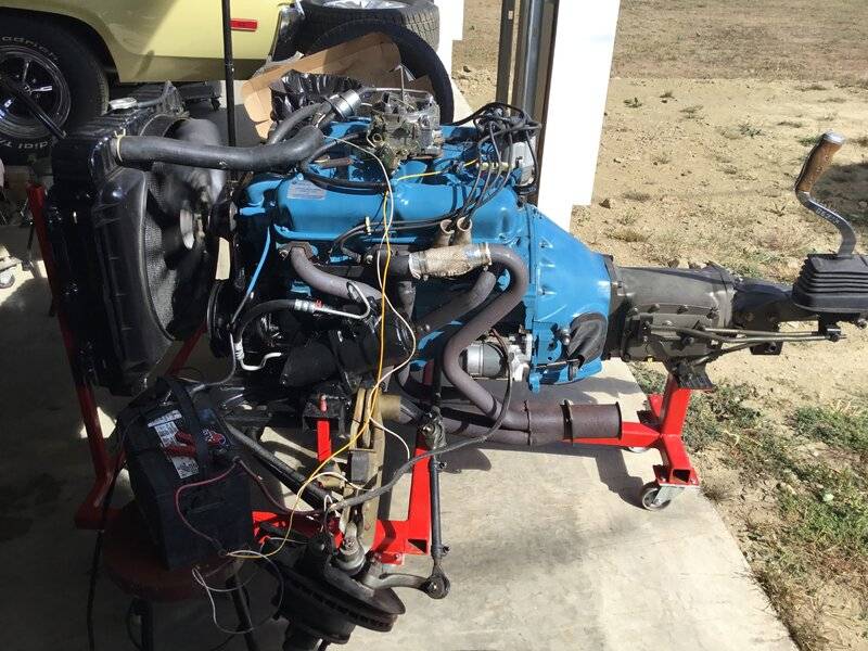

Engine is running. Checked the main and rod bearing, Everything was fine. Installed comp cam CL20-224-4, engine run much better, a bit more vacuum at idle(15 lbs) better throttle response, no pigning on acceleration. Vert pleased with the result.
Cam break-in was done out of the car Used Lucas break-in oil.
