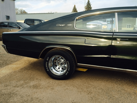

What are those funny Chevy looking things in front of tire. I had our springs rebuilt and raised an inch at the rear bumper.
215x70 x15 on the front. 275x60x15 on a 8”rim,T/A’s on the rear, don’t have any front wheel rub. Remcharger has 295x50x15 on a 10”rim on the back. Had springs redone. He might correct me on my tires and his.
Are you referring to the "yellow" things? Picked those up years ago at a Chrysler/Dodge/Plymouth dealer near here years ago. Had to try them out.
