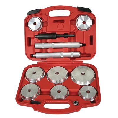

You know, I think I put my first ste of bearings and races in when I was probably about 10 or 11. That wouldda been 75 or 76. I cannot count how many I've put in since and I never once needed a bushing driver. I reckon if you wanna give the tool man your money.....
Rusty, Tools are Cheap when you have the hook up. That set is less money than a dial indicator.

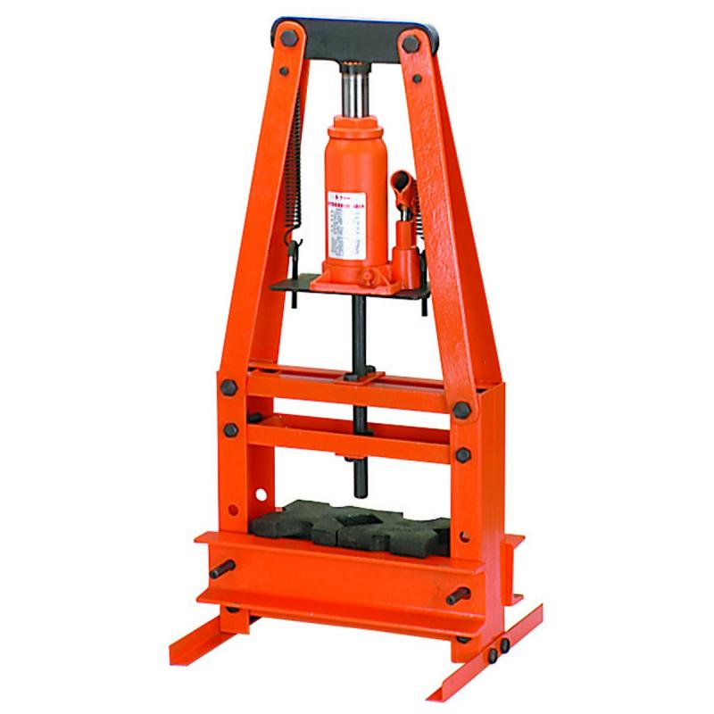

Looks like an older thread.
But for reference, I spent 99 dollars on the floor model years ago.
This one is currently 74.
Best 99 dollar tool I ever got.
Don't like pounding bearings and things in. They cock or something too.
And for a front end, it's "a must".
I bought my bearings at AZ, they lend the tool for free. Made it easy. Here is another thought. The races usually are fine, just replace the bearing. G
