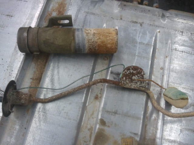

I was planning on replacing the original fuel tank on the 70 roadrunner Im restoring. I pulled out the fuel sending unit and it was severely rusted and crusted over. I was already going to buy a new fuel pump and this mildly built 383 is going to have a holley 850 carb on an eldebrock performer intake.
The only thing I havent replaced is the fuel line from front to back, should I upgrade to a 3/8 from the 5/16 that is in the car now? Im sure this line is just as nasty inside as the fuel tank is.

Here is a pic of the filler neck and fuel sender. Customer cant quite understand why these need replaced.
