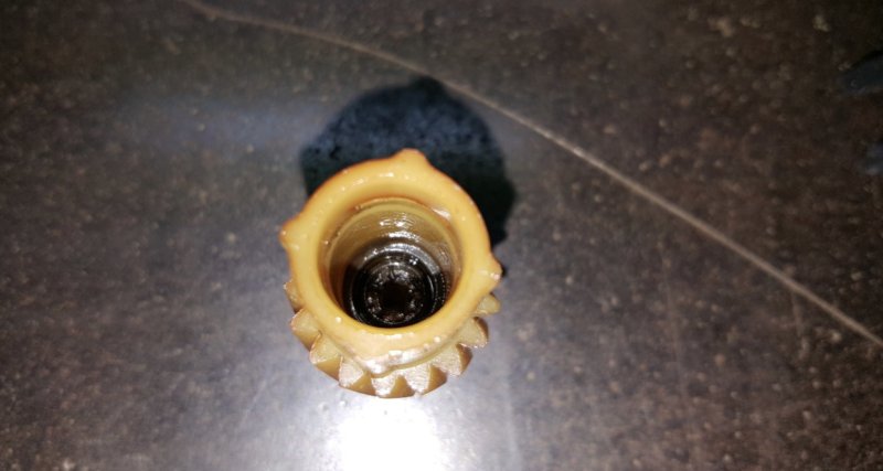

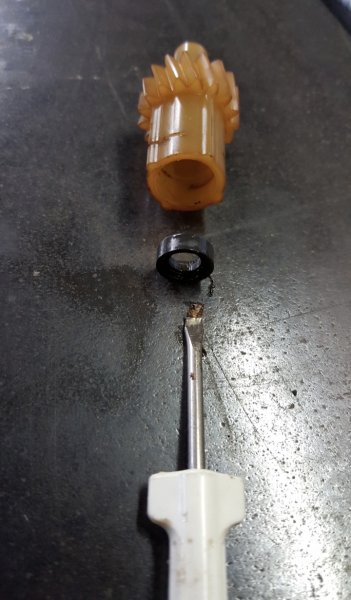

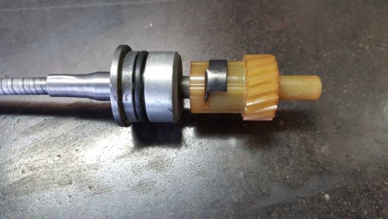

Yours should look like this...

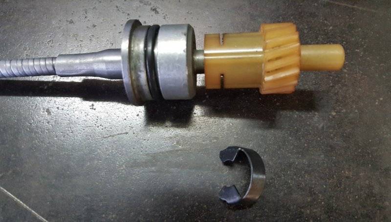

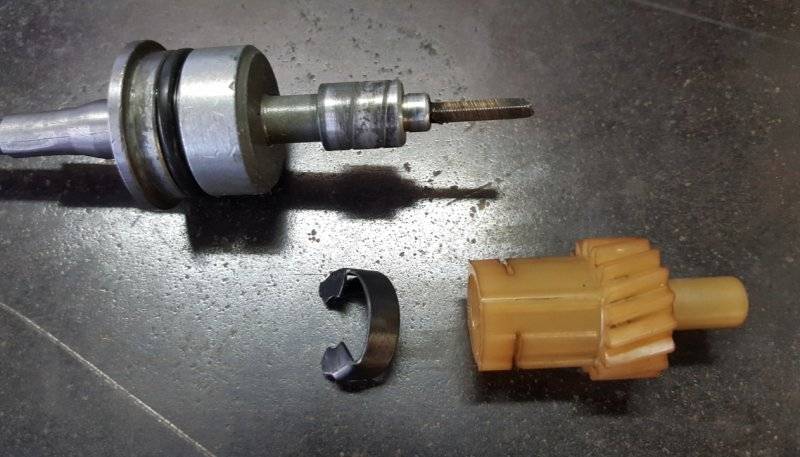

Remove the gear by removing the clip. (Note the orientation of the clip)

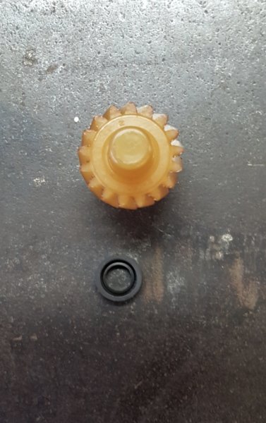

Inside the gear is a seal. (Note the orientation of the seal)

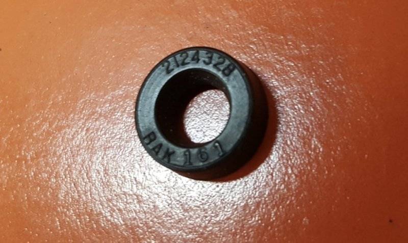

Part # of the inner seal is 2124328
Part # of the outer O ring is 2426332
Several places list them as a set. Ebay, maybe Joe Shusy. Brewers list them in this link. (Read the fine print, they are for '62-'65 727s).

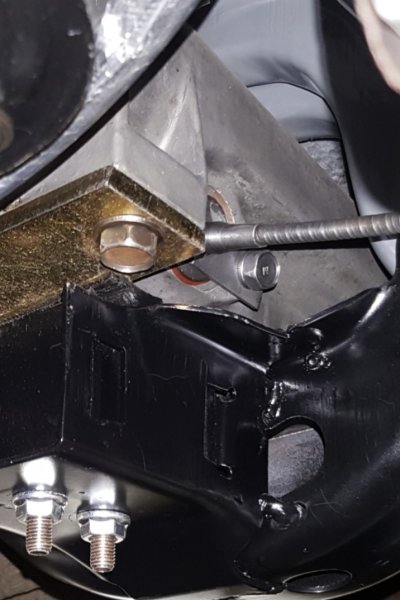

I got the new cable in today. Everything went smooth. Thanks again everyone!
