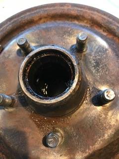

Petty, when I put Righties in my front hub on my 66 Coronet, I first put the front hub/brake drum in the press thinking I could just press them out. NOPE. The Fronts are "Swedged" on (as mentioned above). So, I bent the heck out of the front Brake Drum and accomplished Nothing with the studs. Soooo, I then fussed with it quit a bit and got some help on this forum.

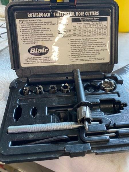

In the end, I put the Hub/drum in the Drill Press. Drum down, Hub up to expose the heads of the old "Wheel Bolts". I drilled I think, was an eighth inch hole in the middle of the heads of the studs. Then I used a cutting tool that is just like what one uses to remove Spot Welds, only larger. It cut the outsides of the heads of the Studs being careful not to go too deep so that I would not scar the Hub. Then back to the Hyd Press and used proper shoring under each stud and pressed the studs out, Heads First (they make a big POP when they finally break loose). Then pressed the new studs in as you would imagine.
The Backs will press right out, at least mine did. Good luck. B.
Here is the tool I used to cut the tops of the studs after drilling an eighth inch hold was drilled in the middle of the heads.
Here are those Pesky Swedges right down by the Brake Drum.
Notice how I bent the Brake Drum already at this point. Good luck. B.
