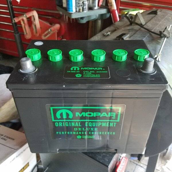

I just ordered a topper.
And when i need a battery.
I just find one that fits under it.
Like so.
NEW 1966-74 Mopar Group 27 Battery Topper Green Caps | eBay

They look good when installed, on a correct looking battery...
