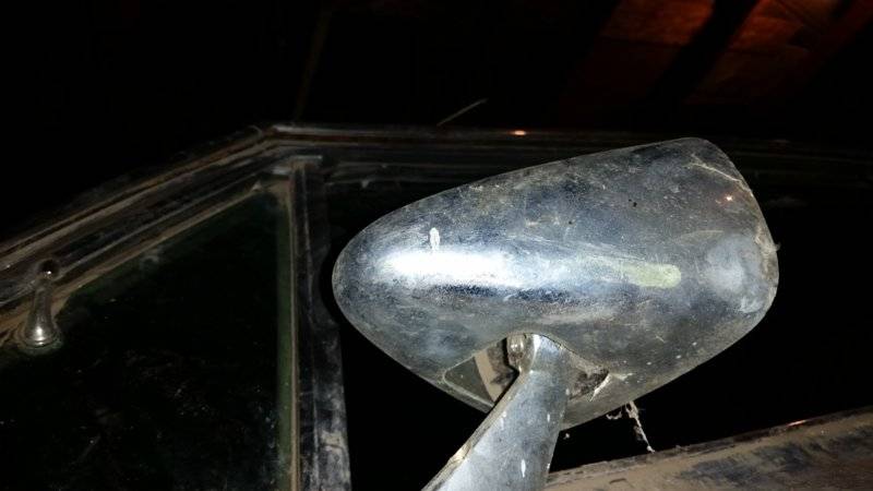

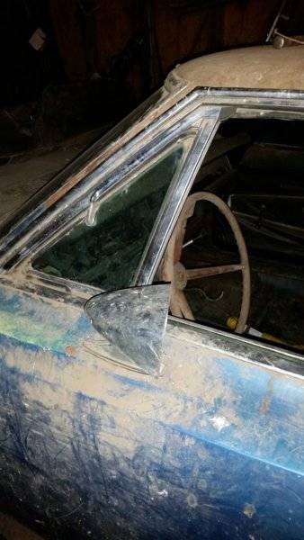

Thanks.. now the only problem is the mirror debate on what was factory on my car. Lol. I think the ones on it are "racing mirrors" as opposed to the stock ones on normal b bodies, but no one ever can tell me for sure.

So the ones on there should be correct. They just didn't paint the lh side one as it was a remote style, correct?
No. The decode was the polite way of saying the mirrors are wrong. The tag codes G31 and G33. There’s no G36 on the tag as shown in the decode.
G36 painted mirrors were not released until March. Your car was built in October; six months before they came out.

You data plate state inside remote mirror on the drivers side. That is not a remote mirror nor is it a factory mirror. Watch this video This charger has the dual sport mirrors that would have came on all B-bodies in 1970. They do not look anywhere close to the junk that is on your car.
Thanks for clarifying. I will have to start looking for some factory style ones
