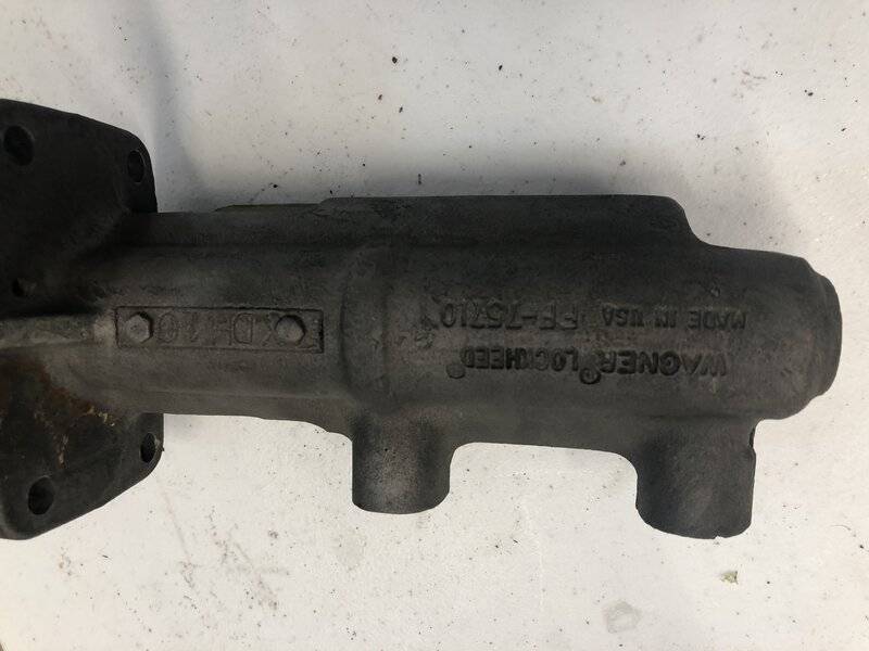

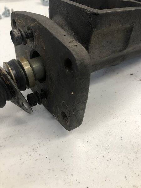

Here is a picture of mine.
Not a Bendix however I believe it’s original could be wrong
Thoughts?

I have an extra original on the shelf. But its also an old aftermkt reman, same as the one on the car. I switched rubber gaskets and it still leaks slightly. casting seems fine, smooth with no signs of pits but I cant tell if the surface is flat or not.
Im going to switch the lid next and see what it nets me this weekend
