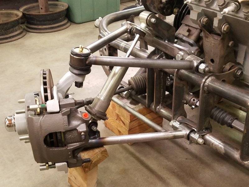

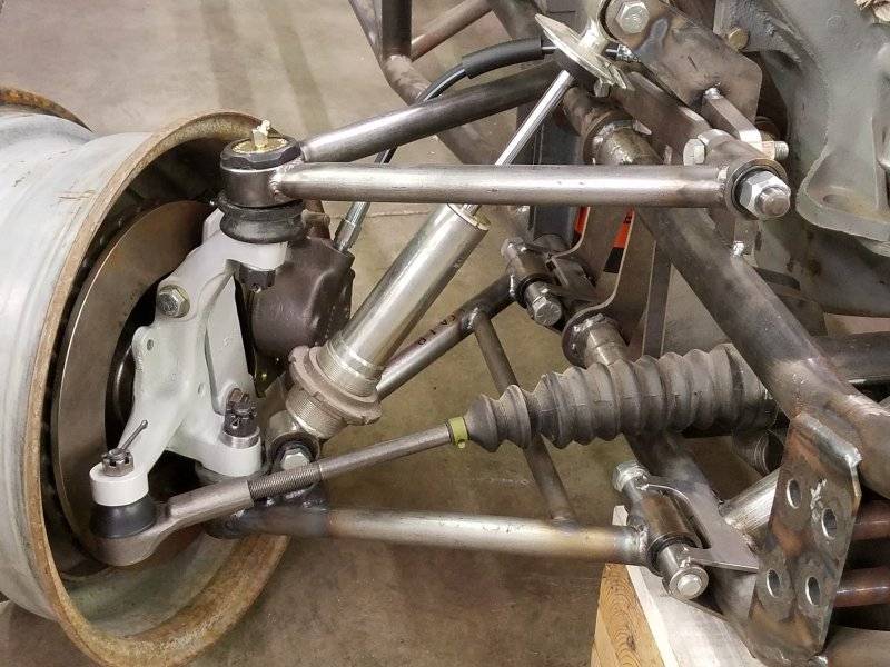

Made a jig, and built my own.
But they're for a custom build.

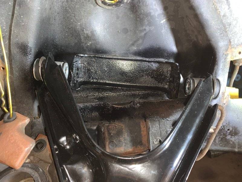

I got the repop arms with bushings. They seemed high quality, but were a little too wide going in (see pic). It's been a while, but as I recall I ended up setting them on end using a bfh and pounding them a little closer together. Eventually, they went in and the rest of the suspension rebuild proceeded. Alignment went well (after I taught the alignment guy how to do it lol). Anyway, after 3 years and 10,000 miles, no issues. Car drives like new.
