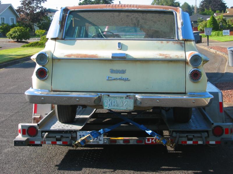

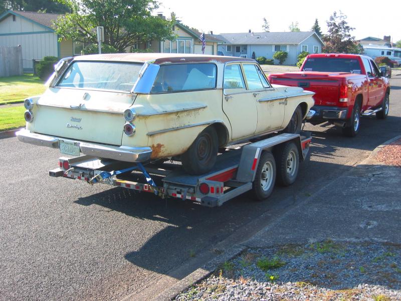

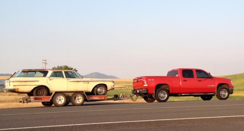

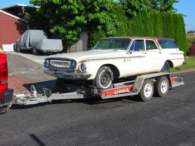

:evil6: LOL - What area in Washington - We do have desert you know. My Dart came from the dry side Spokane area, yet still had lichen on the outside around the trim. And mold on the inside seat vinyl, which scrubbed off. Floor needs replacing from rain and snow water getting in and rusting them from the top down. Rear qtrs need patches down low.
Post some pics!
:toothy2:
