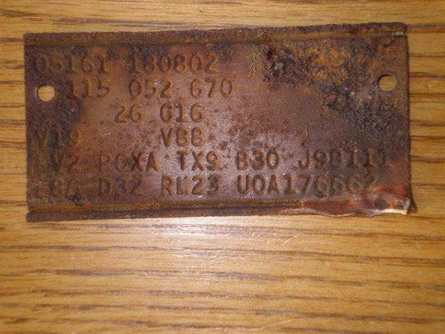

Remove the fender tag and flip it over. They can be rusted pretty badly and still be readable from the back. Restore it or pass it on to someone that will!.
:worthless_thread: back side of a very rusty real superbird tag I own
