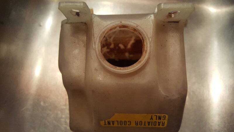

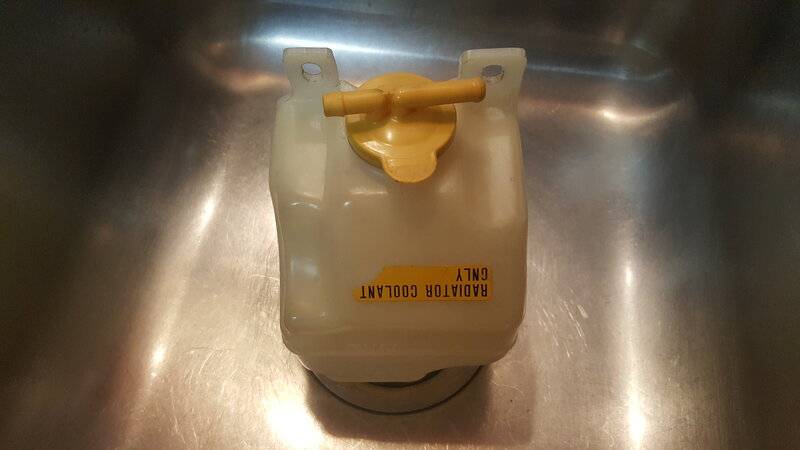

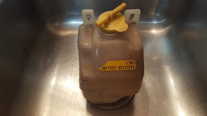

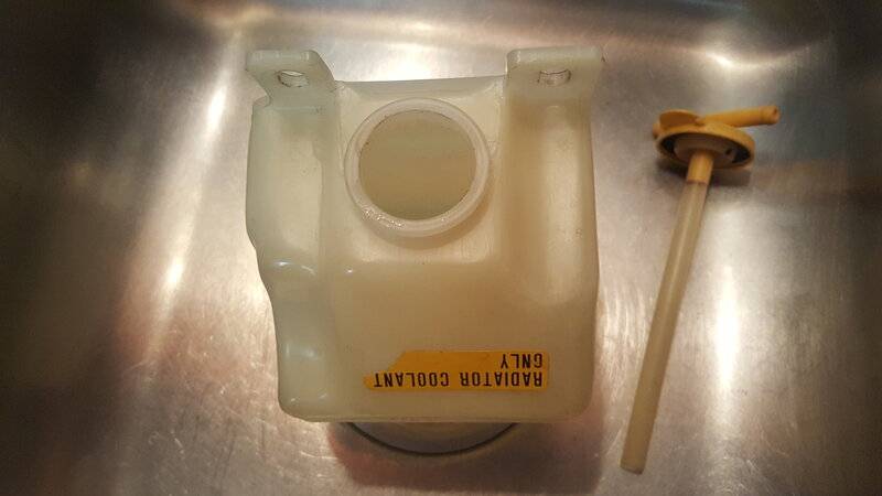

Not a Mopar, just a used car that I'm detailing but I thought I would share. (This was just one application)
I've seen several videos of people restoring their radiator overflow bottles and most are using an acid of somekind. I thought, hey I have some aluminium wheel cleaner that contains acid.
