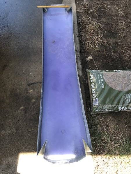

I picked up a used trunk panel several years ago that was in fair condition but had one dented area along the top that I mostly massaged out some tim ago. I decided to finally get around to finishing it. First thing was to strip the anodizing use lye crystals and a dipping tray an air conditioner mechanic friend made for me.
Submerged for 35 minutes
Out of the stripper
Rinsed off

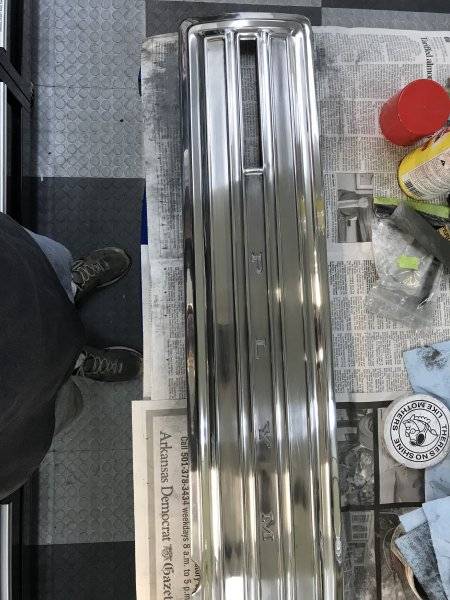

Working over numerous dings and sanding down for polishing. Realized I forgot to remove all the paint in the letters which protects the anodizing from the stripper so had to go back and touch those areas up. Sanded down to 2500.
After polishing with two grades of compound and cleaning with Mothers aluminum polish. I didn’t sand out every last ripple in the flat panel areas or polish those areas as they get a flat silver paint.

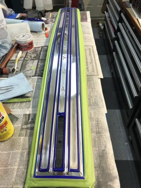

Masking off for paint
I’ll try and paint in the next couple days using a light coat of SEM etching primer and Krylon 1403 dull metallic silver in the flat areas and red in the stripping areas
Not sure what you're cleaning with... but that Mother's probably has silicon in it so make sure you've cleaned it a 100 times b4 paint.
I think it does have something along those lines in it. I wiped down all the areas to get paint multiple times with 99% isopropyl alcohol. May hit it with prepsol before I paint.

Painted it this morning and it came out fine. I’m going to have to let the paint harden a few days before doing the lettering as the black was trying to melt into the flat silver.

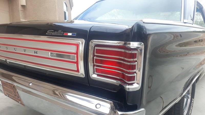

Looks like my red is a little darker than yours. Kind of hard to figure off of computer pictures the exact shade sometimes. Polished aluminum loses some of the softness in appearance of the original anodizing - looks a little more like chrome. But if not 100% correct it will match the tail light bezels very well.
I think they are a darker red. Something to match the tailights. Seeing two shades of red would look odd to the designers.

Bill's pictures look darker red on bottom and looks like there's a lot of direct light on the top.
Well, I think mine might pass for dark or blood red.

I think Mine is darker in person than these pics show it to be ( at least on my monitor )
But I dont think its as dark as yours though
