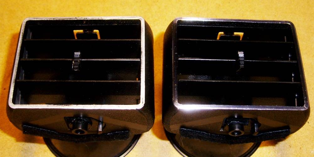

Test: The first thing I tried fixing is one of my A/C vents. My picture didn't come out that great but, trust me
it looks better than new! :hello2:
Before and After picture:
Protesting!!! Re-shoot!
LOL! How's it going! Long time no see.

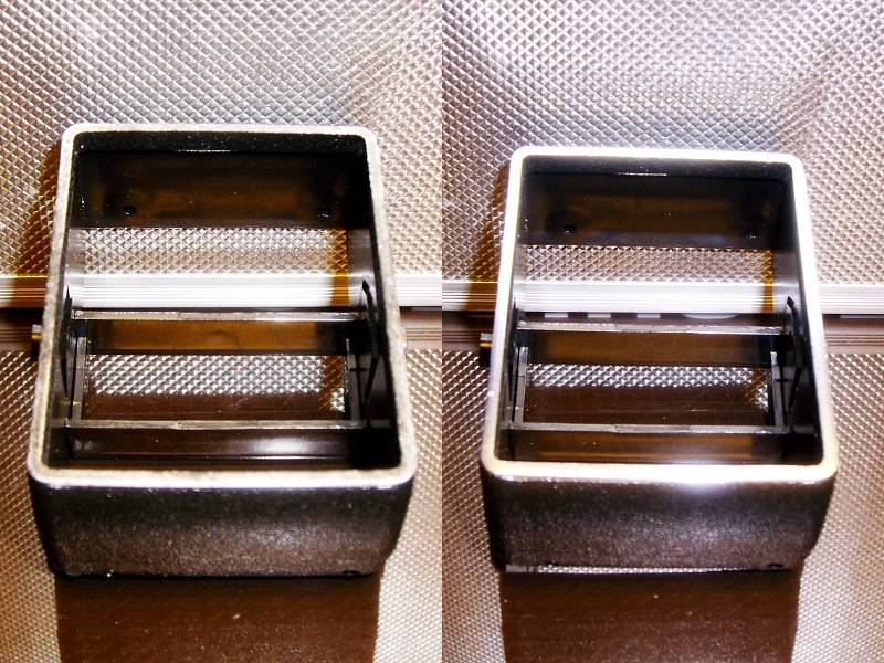

Hopefully a better picture? See one is silver paint(before) and the other is chrome(after)!
I've never worked with this stuff but, kinda liking it!
yeah, I was going by the place and thought I'd look for some glue for my gold and silver foil? Found this stuff and thought I'd give it a try.

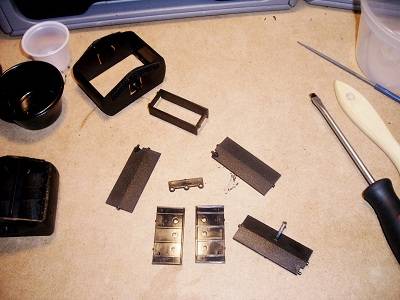

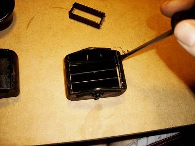

Long story short: First you need to carefully remove the vents by removing the dash pad. They are screwed into the back of the dash pad. Using a flat screwdriver through the front of the vent pop the bottom and top pivots and push back and they will come out.
The frame piece in the vent in the back will easily come out.
To remove the shutters simply pry one side in to get them out.

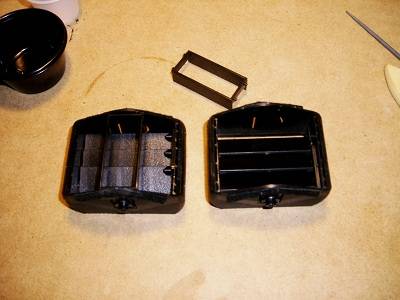

It will fall apart into separate pieces, Very important -now wash everything with soap & water.
Note: You could try this with out taking the vent completely apart. It's very hard to get it back together if you've never done it before.

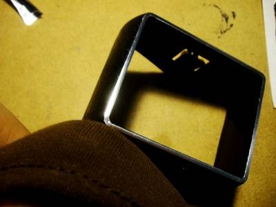

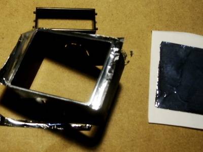

Let all the pieces dry, I scrape the old Chrome off with a sharp razerblade.
The razerblade leaves it smooth and clean.

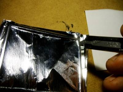

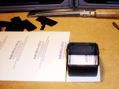

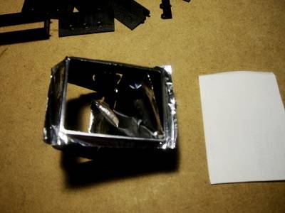

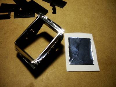

Size the piece on the Bare-Metal sheet and cut to size leaving a little over hang to make it easier to trim.
For this small of a piece I separate the foil from the backing. It's like a very thin tin foil, so be careful not to let it curl up and stick to its self. Save your backing paper!

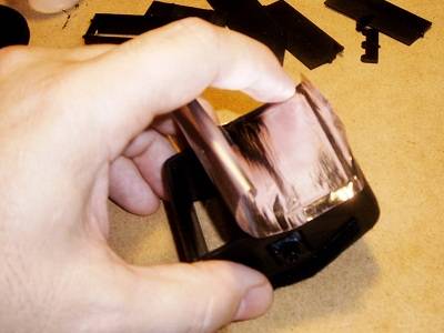

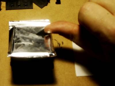

Apply to the vent face using you finger lightly to rub into place.
Once it is in place go back over it with your finger a bit harder to make sure its applied to the vent rim.
I use the back of my fingernail in pushing and getting out wrinkles in the foil.

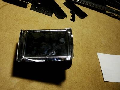

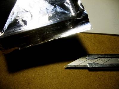

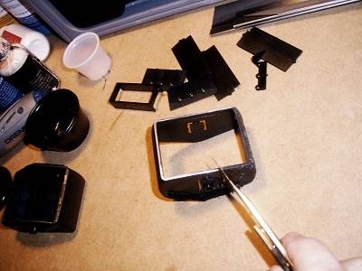

Make sure not to fold the foil over the sides, lightly pull the edges out to make it easier to trim.
Use a fine point razerknife.

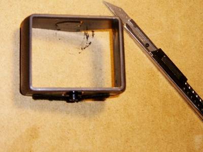

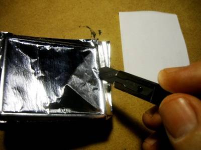

Use the tip or smaller part of the knife to trim the inner corners.
For the sides cut/trim in a downward motion, so as not to pull up the foil.
Once you've cut the inside foil out save it for future projects.
Now you know why I said to save the backing paper, re-apply it to the paper.

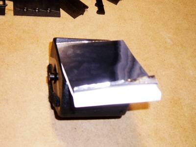

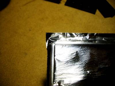

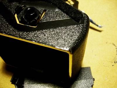

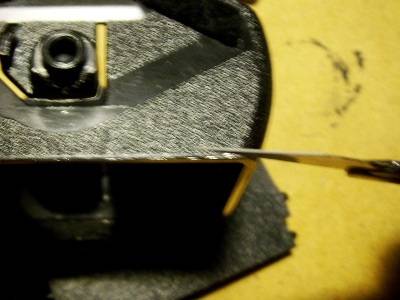

Trim the out side edge the same way, this time you don't need to cut in one piece.
You may have some foil on the sides, not a problem!
Take your knife and cut or you can lightly scrape the access off.
At this point, take a cloth or in my case my shirt and rub/polish the foil to get the chrome look!
