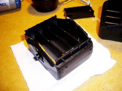

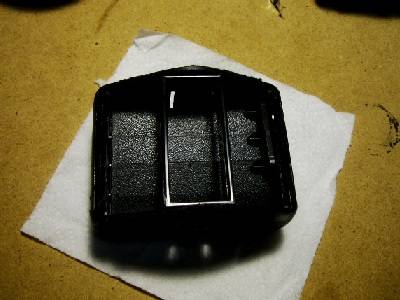

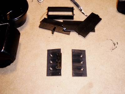

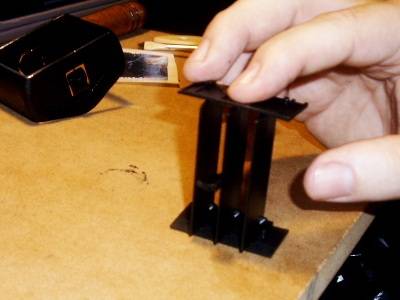

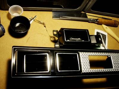

OK, now we need to put it all together. For best results put the parts together out side of the vent.
Use one of the other vents to make sure you put it together correctly! And it should look like this.
Carefully drop the guts back into the back of the vent. Snap in the sides.
Re install the frame piece and its ready to be put back in the vent holder. Push it in through the back side while making sure you don't scratch the work you've done!
Re install and your DONE! They look NOS new with out the big price tag!

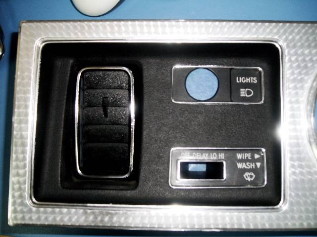

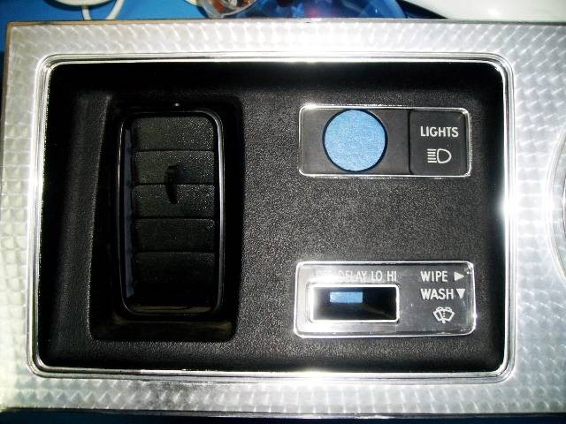

An exact match to the chrome on my Digital Clock!
I'm a bit disappointed, my clock chrome trim was already perfect?!

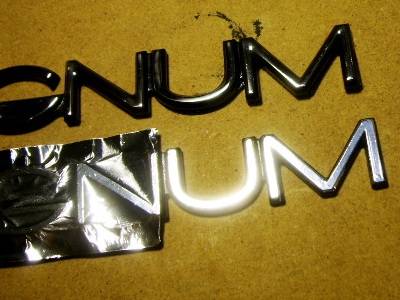

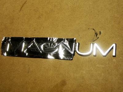

I have a mold for making Magnum emblems and had a few made laying around so figured I would chrome them too! :) Anyone needing "MAGNUM"(fenders & trunk lid) or the "DODGE"(headlight cover) emblems? I can make them just about any color! (Red, White, Black, Pink, Purple or Blue all with Chrome)
