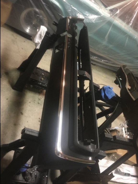

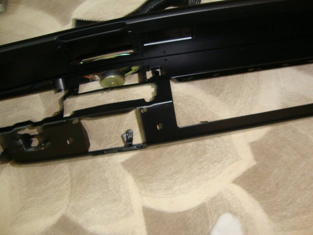

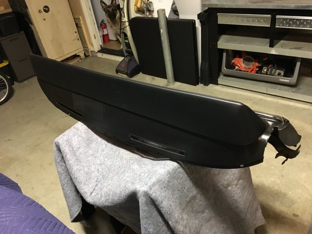

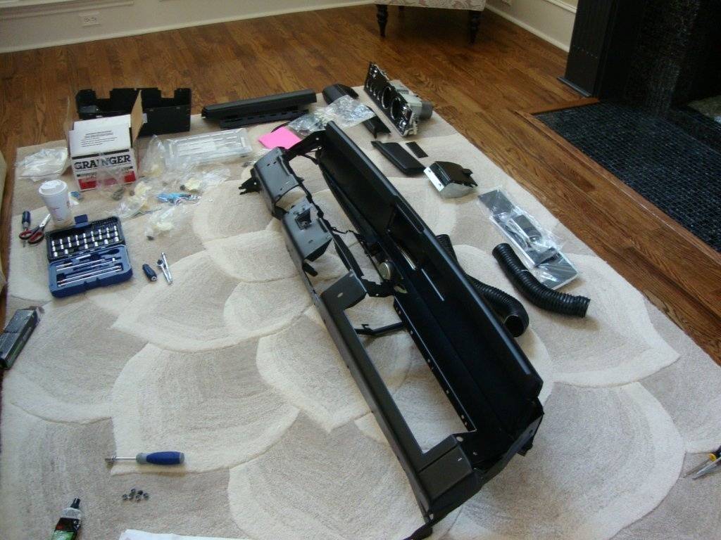

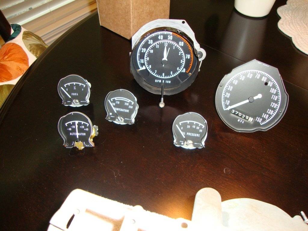

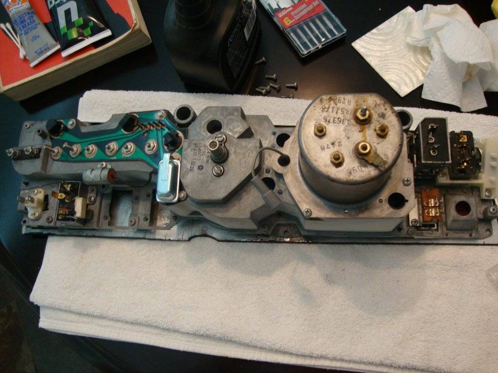

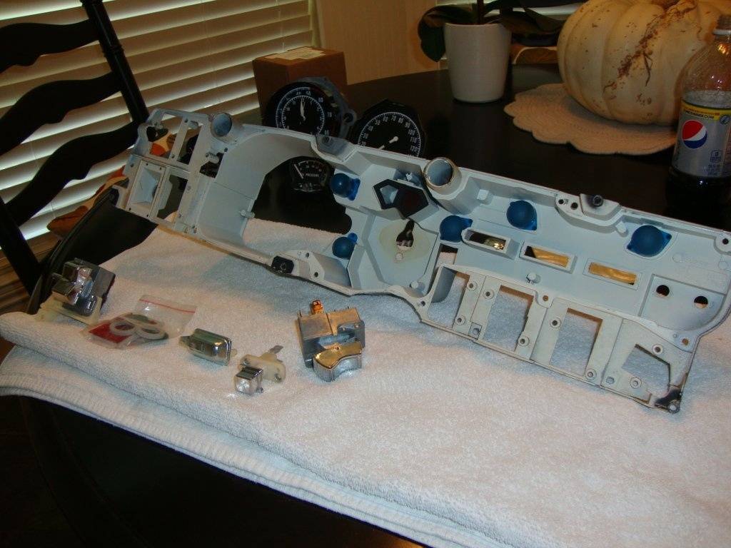

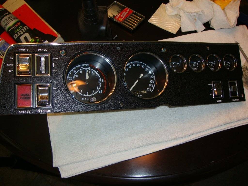

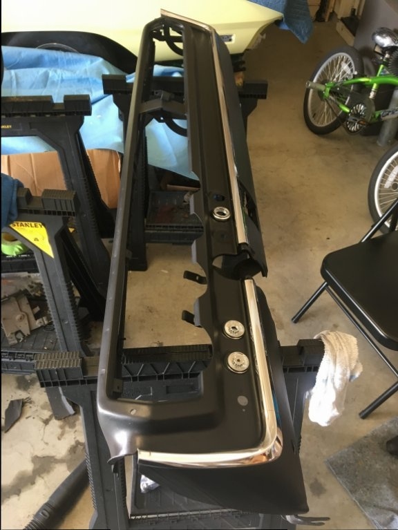

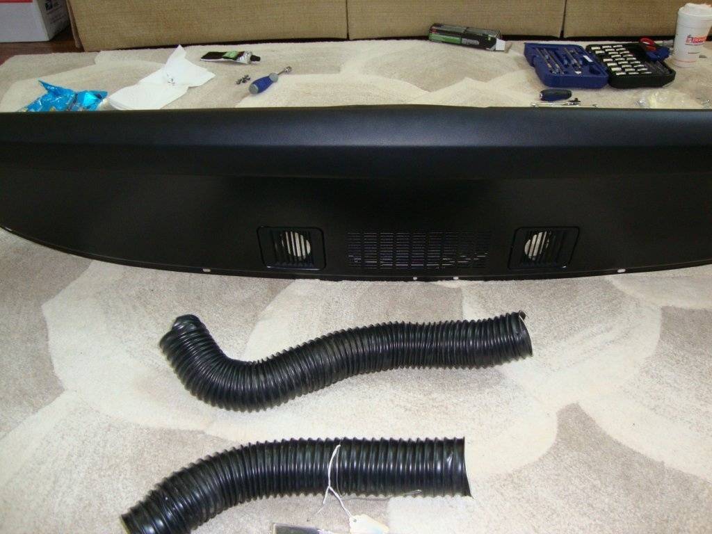

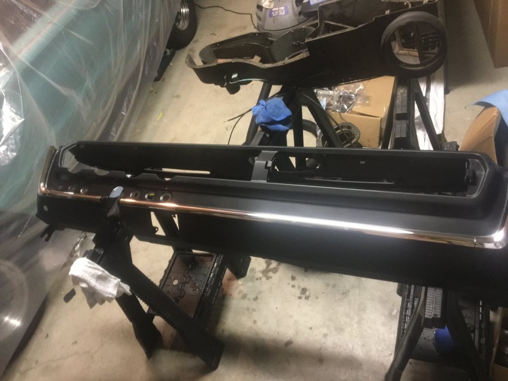

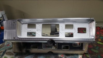

Driver restoration from my home garage
The above pictures were before.

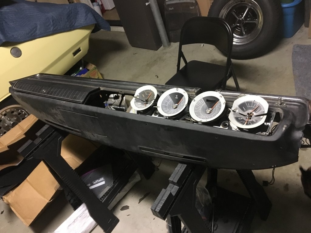

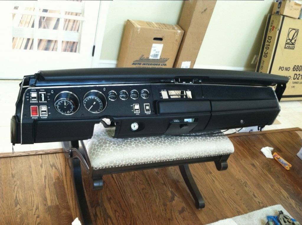

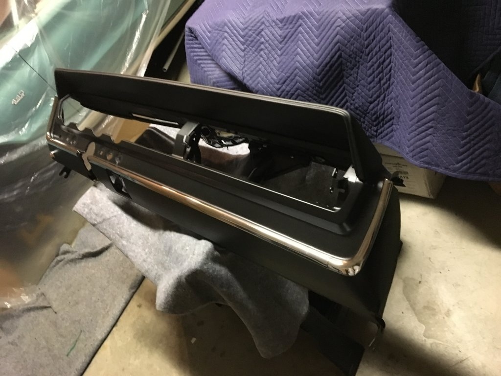

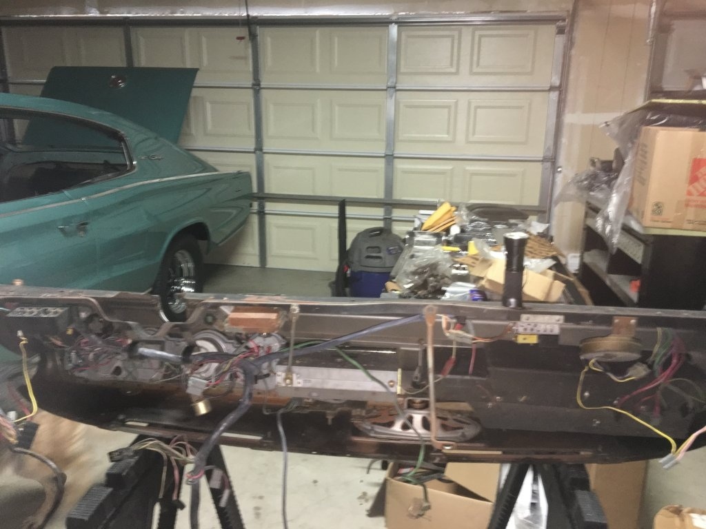

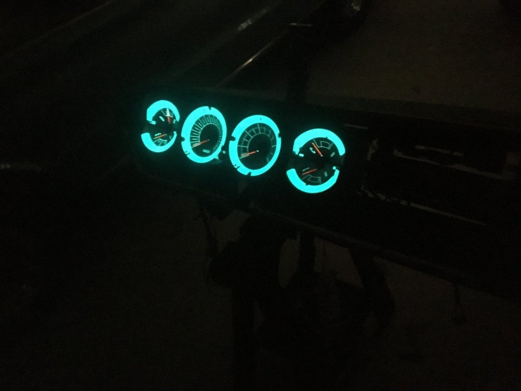

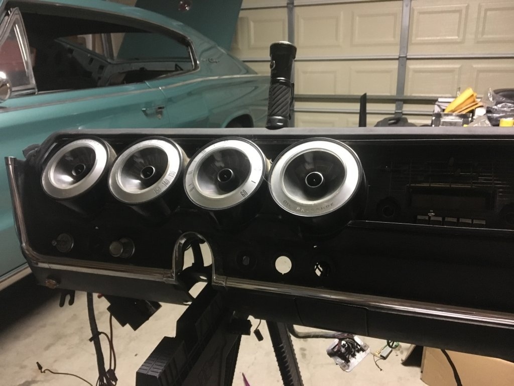

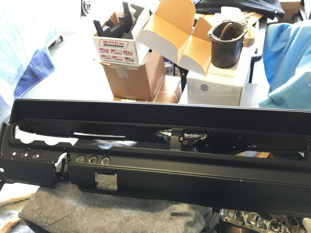

This is during... still working on it..
I have no time lately..

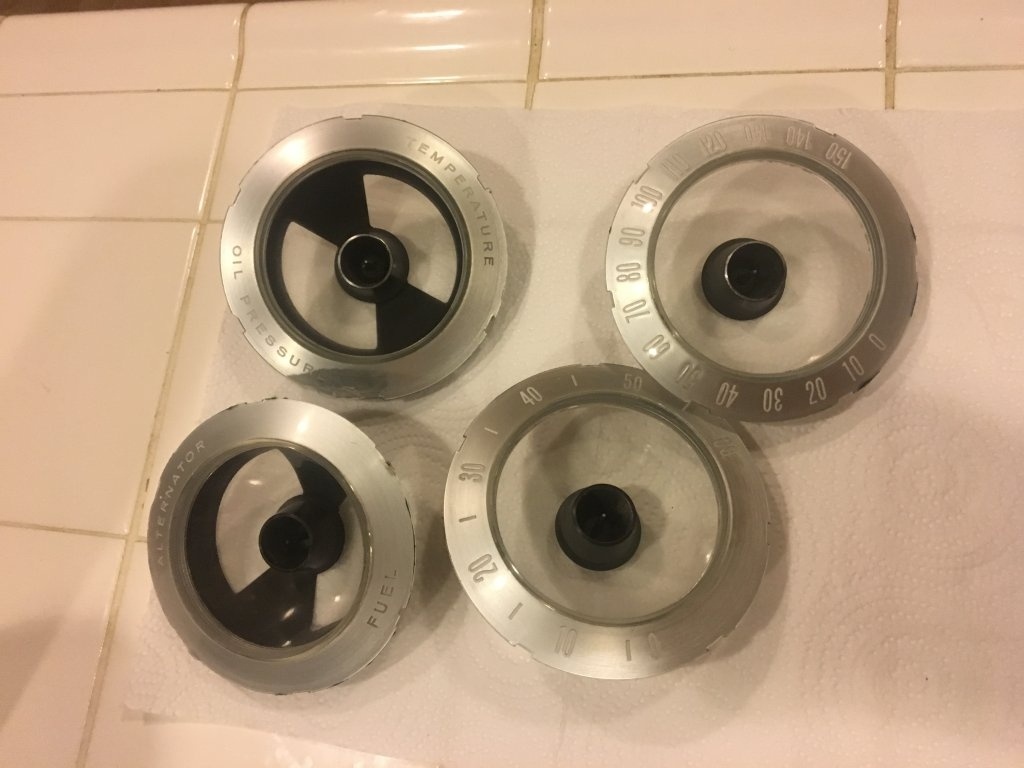

Cluster bezel and glove box door and inside bought new. Not installed yet cuz I'm calibrating and cleaning gauge faces. Polished my own lenses.

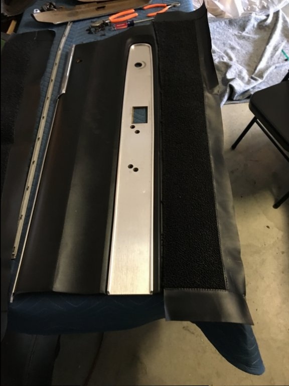

IMG_0084.JPG IMG_0191.JPG IMG_0385.JPG IMG_0386.JPG IMG_0391.JPG IMG_3744.JPG IMG_3893.JPG IMG_3917.JPG IMG_3919.JPG IMG_4005.JPG

My 69 charger dash I created a paint booth in our fourth bedroom, no kidding....The exhaust was the window, lol....I purchased interior paint from PCG and painted the black pads....When you do these clean clean clean and More cleaning. I start with see vinyl prep. Cleans well and softens the vinyl. These wash with soap and water.....I always use an adhesion promoter, SEM brand. Then the clean it tons of light coats. We are not painting a car here we are slowly bring the beautiful black back...
Dash frame, I stripped with stripper completely. Removed a particulate plate, lol. Sprayed the well cleaned bare metal with self etching primer. Then a dp epoxy. Prepped and spayed the correct textured lacquer from IS. Lacquer is an art to spray and is done in thin coats. VIN plate was sprayed with a semi gloss and ECS rivets and logo transfer was used.
Tested all gauges appropriately except for speedo sprayed the gauge faces with matte black and applied the gauge face decals. All switches were replaced with NOS units. New glove box. The panels were sent out plastic chromed and painted and white lettering placed. The heater control unit was restored by PCG....

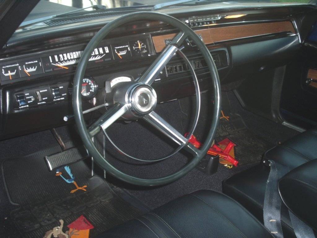

I did mine by myself. First removed all pads, trim and gauge cluster/switch panel. Cleaned everything and then tested, adjusted or replaced what wasn't near mint condition. Dyed the vinyl pads so they looked new again. Used Rustoleum textured black paint on the dash and switch panel (plus steering column). I sprayed the dash and steering column while still in the car, but spent a lot of time masking off everything that wasn't going to get painted. I repainted the gauge needles with fluorescent orange and polished the lenses with Colgate white toothpaste and a soft rag. Painted the lettering on the switch panel by applying white paint to a rubber eraser and then dabbed it onto the raised lettering. I reset the odometer to 00000 as it had been disconnected for years and I just rebuilt the engine. The reading was at 98,000 already.
Just take your time. Make it look like something you'd be proud of and then say "I did it myself"!
