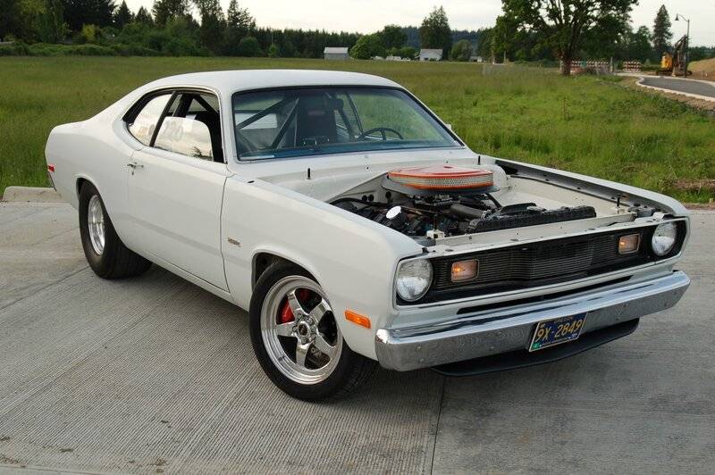

Sure, people have been doing it for a long time. I might have been the first to do it, I had Viper calipers on my Coronet back around 2002. Don't know of anyone who did it earlier but it is possible. I even showed how to do it in the B body book that I wrote a few years back. My Duster has Viper calipers on it. This is such a common thing that you can buy a complete Viper kit from Doctor Diff for A, B or E body cars.
