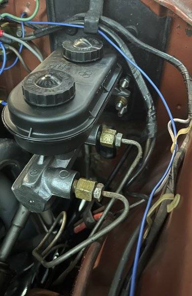

Before I pulled the engine, trans and K member, I was using a stock 1975 Dart power booster and 15/16" master cylinder and the brake pedal pushrod was bolted directly to the pedal arm with none of the factory style power brake linkage that B body power brake cars used.
The front brakes are the Cordoba 11 3/4" rotors and 2.75" calipers with Carbon Metallic pads. The rear is the 10.7" Dr Diff disc brake setup with a 1 1/2" caliper. The brakes are okay but not spectacular. My '72 Duster has the 73-76 A body 11" front discs but with the bigger 2.75" calipers and 10" drums in the rear. 15/16" non power master cylinder. That car flat out S T O P S !! My "Jigsaw" Charger has 11 3/4" rotors, 2.75" calipers, 10" rear drums and a non power 15/16" master cylinder. That car stops great too.
One thing that I am unclear of is the bias that is preferred in terms of front to rear caliper bore sizing. If I have a 2.75 front caliper bore, what is the optimal caliper bore size for the rear?
Along the same theme, If the rear bore size is too big, what size do I need for the front to be?

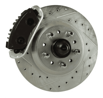

This Dr Diff Cobra brake package does not list the size of the front caliper piston.
The picture shows 2 pistons though. What if the total surface area of the 2 pistons is smaller than my existing ones? Would that lead to a rear brake bias and make a swap like this an actual step backward?

Taking the Cobra 2 piston caliper into the mix....
1.5" caliper bores x 2 equals...... 3.14 x .75 x .75 which = 3.53" of surface area. That is less than half of the single 2.75" piston in my iron calipers.
I'm trying to understand how a smaller surface area amounts to better stopping force.
Maybe....the smaller clamping surface area requires less fluid pressure and volume to work?
Maybe with the same pedal movement, the smaller twin piston caliper moves further and clamps harder?

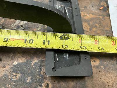

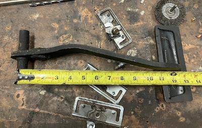

To expand a bit on the last post:
I forgot to mention that at some point, I removed the brake pedal and drilled a new pushrod hole above the stock one.
Going by what I have read, the working length is from the top bolt from which it swings....
To the center of the pedal where the lever is welded.
With that, I measured 12 inches.
The next measurement is again from the center of the top hole to the center of the pushrod hole.
Stock seems to be somewhere around 1 13/16"....call it 1.81.
I modified this one and it measures 1.46 center to center.
Stock pedal ratio......12" divided by 1.81 = 6.62.
Modified pedal ratio...12" divided by 1.46 = 8.21.
Yes and yes. Smaller piston with same pressure applied will move further. It may make the pedal feel firmer as it requires more effort to apply a smaller piston. Look at a floor jack, 1/2" piston applies a 2" piston. You need a long handle to generate enough force to make it go up.
