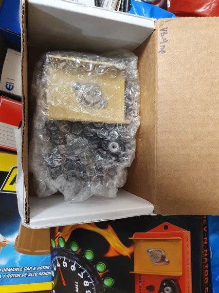

Rev-N-Nator Not Available?

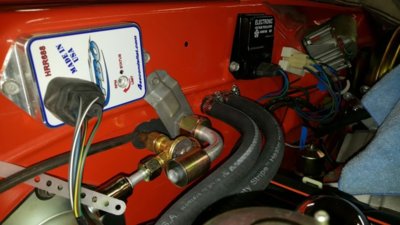

That tan box is for the electronic vacuum retard. PIA system.
Usually the HP cars. stupid system it also goes to a solenoid on the carb and when you shut off the car it retards 5 degrees and the solenoid drops. Think about it I get the solenoid but retard the vac with the key off???????
Best thing to do with it IMO is find a way to remove/disable it.

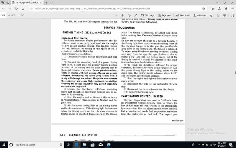

if the vacuum side is good it will work like a regular vac advance. I have seen them also on 2bbl 383's. Only way to tell if it came on the car is look up the car in the FSM. I have the sun cards that I look up the distrib number on to tell. You can take it off and put a regular style vac advance on it. Just have to match what it is in vac advance degrees.

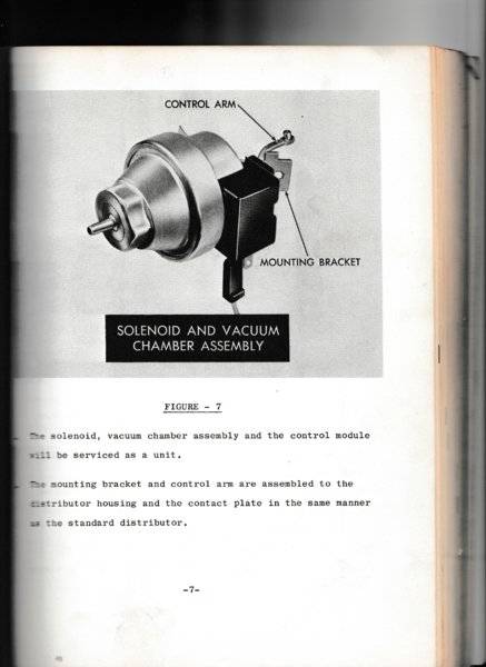

A more accurate description of the functions of those solenoids. Other than the insulated contact mounted on the idle speed solenoid plunger for the retard solenoid, the two systems have nothing to do with each other.
I agree but some years they are tied on the same circuit. I will find a reference not going to beat this to hell like on FEBO did
Both are powered from the Ignition 1 circuit in the engine harness but their functions are not related to each other.
Some retard solenoid applications did not involve a curb idle solenoid, had a simple insulated curb idle screw and contact. Timing was only retarded with ignition on and at hot curb idle.
