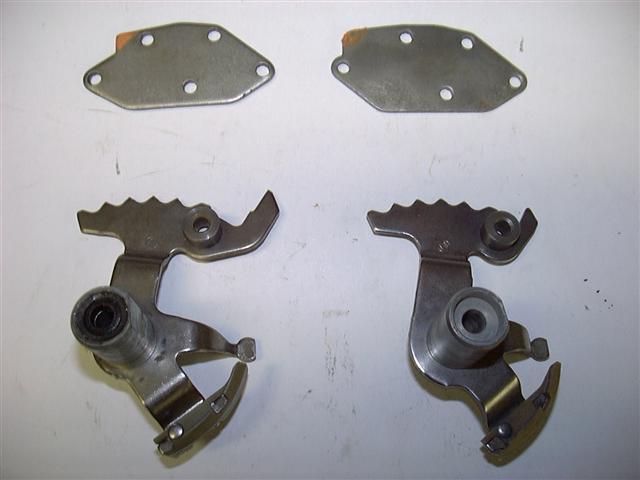

Sounds like you need to change the rooster comb to a 70 up one.
The rooster comb/switch is different. The easiest thing would be to swap the neutral saftey swith to the single pin. Then forget the back up lights. You could also swap in your old valve body and use the 3 pin switch. Swapping the rooster comb between years has a few other things to go with it and can get tricky.

Can i change anither rooster comb to have one that will work with 3 prongs? Are they interchangeables if i drop the valvebody ?

The simple fix is to use the single prong switch and just wire the backup lights to a toggle switch. To change the rooster comb you will need to find a 69-70 comb which will work on the early transmissions, a 71 up will also need the valve cover changed as well. Pictured below is a 69-70 left, 71 up on the right with corresponding valve covers. Might be easier to find a complete valve body than just the parts. 71 up would also provide part throttle kick down which your 67 valve body does not have. Have you dropped the pan and verify that you do in fact have a 67 valve body?
