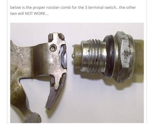

Did they rebuild your original or swap for something else. There are 2 different rooster combs.
Or did the plastic piece got broken or removed.
the photo is what yours should look like. 1968 and older was metal only with 2 rounded nubs to hit the switch.
Also if the trans case gets rolled on it’s side it bends the tangs on the 3 prong switch so you could have a used replacement switch from the shop.
