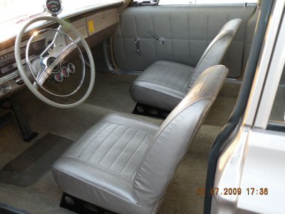

I drive mine on the street and just kept park. Trust me you'll need it.
