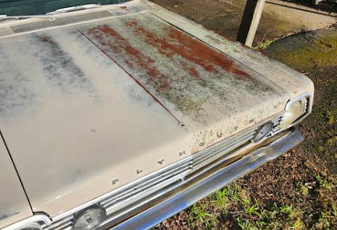

I'm trying to get my first car which is a 66 Plymouth Belvedere back on the road. (I had it for 28 years) I decided to stick with the 2 bbl carburetor. What 2 bbl carb for a 273 is recommended? Any other suggestions for the car? Any certain plug/wires would best for the 273? etc. thanks.
