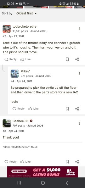

Lol that's just how it works. Do not test that way
It will disaasemble if you run it outside of the throttle body.
